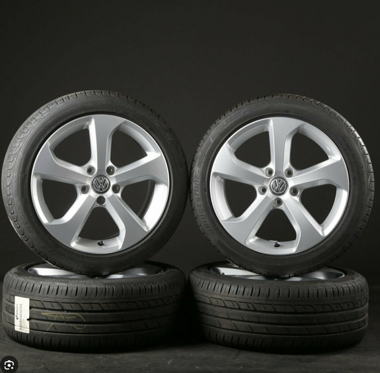

 Please anybody know if the rims Brooklyn 225/40 R17 7.5J ET49 from the VW mark7 GTI will fit my stock Golf VII Variant with any issue? (offset, suspension strut clearance, poke out, etc.)

Yep should be a straight fit, but you may be thinking of the Austin alloys in 18inch, depending on where you are you may struggle to get the Brooklyns as they're a North American alloy.

As above, the wheels will fit fine but the tyres will need to be 225/45/17  not 40 profile :afro:

I made a mistake, tyre profile is 45, not 40, thanks Exonian :) I got those Brooklyn rims today with those mentioned summer tires (to be honest there were a few offers available for these rims)...so now I just need to wait for spring/summer to try them :)
