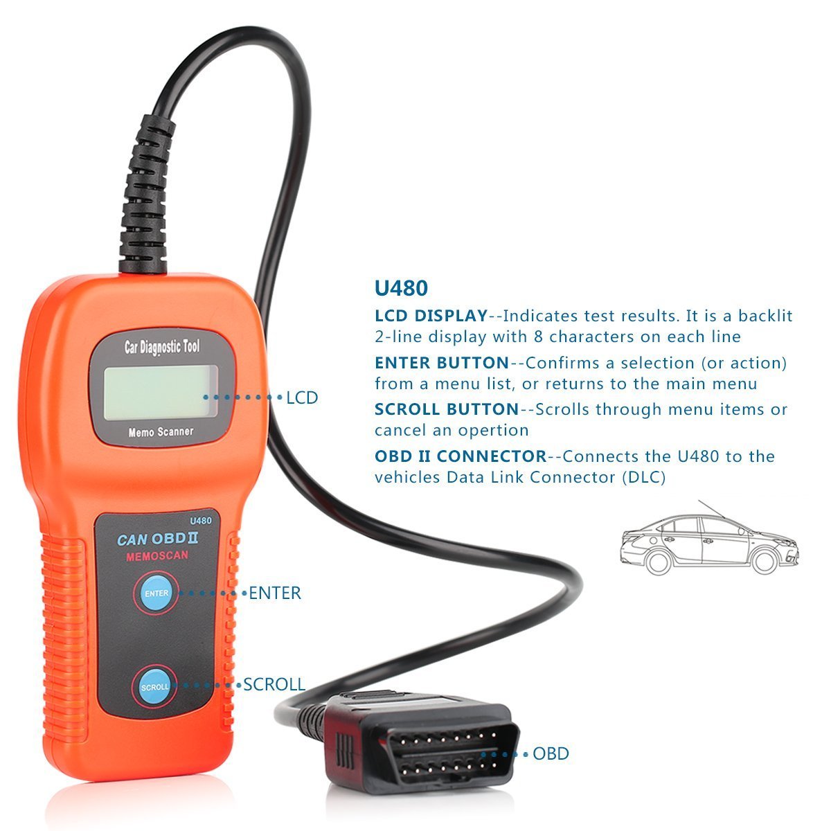

If you look on the back of the connector in your car you will see that there are only about 5 wires in total on the back of it.
The scanner in the pic below would do you a turn.

So the U480 is incompatible with my motor (8V AGG)
Offline itavaltalainen
  • Posts: 2,693
  • VCDS and VCP - fault codes, coding, VIM activation
Re: U281 / U480
« Reply #3 on: 27 January 2016, 09:02 »
The U480 is for CAN OBD2 vehicles only - the mk3 is only OBD1 (1.5 maybe - only has an OBD2 plug).
