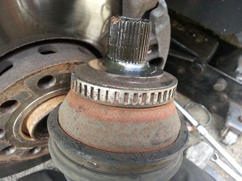

See how that isn't on dead straight, just slightly out?
This one would do it on a tiny bend at 60 MPH.
ABS ring or sensor not in place properly.
