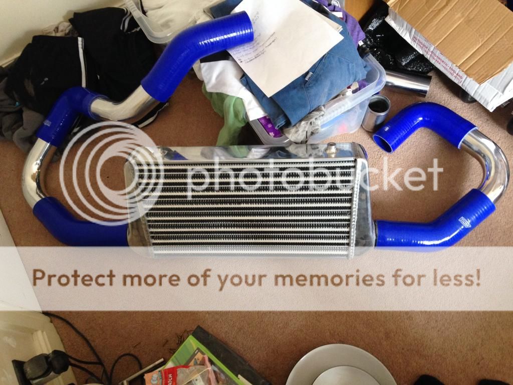

Does this look about right?
« on: 31 May 2014, 11:10 »
Does this look about right for an AUM??

You need the pipework from the turbo outlet to meet that 90 degree joiner, you also need a map sensor flange somewhere in there, preferably in the stock location. It's hard to say if the pipework as a whole will clear the slam panel.
Have a look through rio gti's build thread I believe he did his own charge pipes, top bloke.

Cheers mate. Will stick the TIP in now instead and leave the cooler for a while ha ha.
