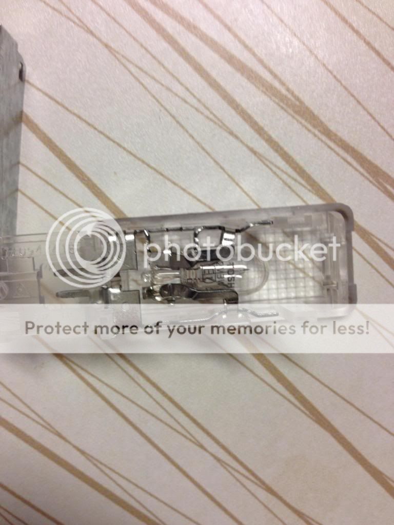

So I finally got round to ordering and then trying to fit the boot light - easy job done in seconds. The glove box light not as easy managed to get it out and open
Somewhat confused the bulb that's in there and the LED I purchased two different size and fit bulbs
Can someone advise which bulb I should be purchasing the LED in the pic is a 42mm festoon

Somewhat strange as I replaced my boot bulb with an LED festoon one today.  You should've have that light holder in there, that is a W5W bulb, you can get these in LED form so not anything to worry about.
Incidentally I'm looking for the housing you have so I can use it for the footwell with a W5W bulb (different coloured).  Can you please let me know the part number that's on the unit?  Would help me in my search without speaking to the dealers :)
No holder in the boot. I will get the part number for you tomorrow if i get a chance. However, car going into vw for the suspension issues. As soon as I get a minute I will get the part number.
The w5w bulb do you know where I can get the led equivalent.
