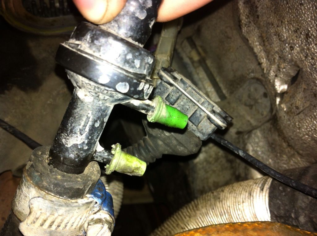

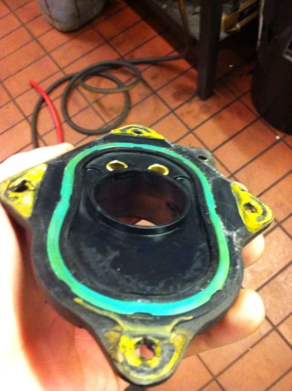

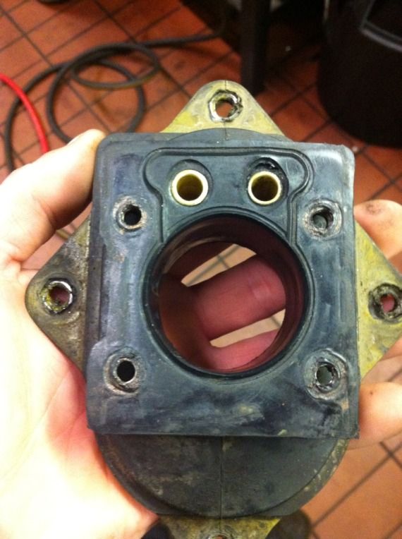

Tonight's findings
Green gasket is completely flat now
Top right brass ring has split around it and risen so possible cause ?
And should this piece have one or two green plugs ?
