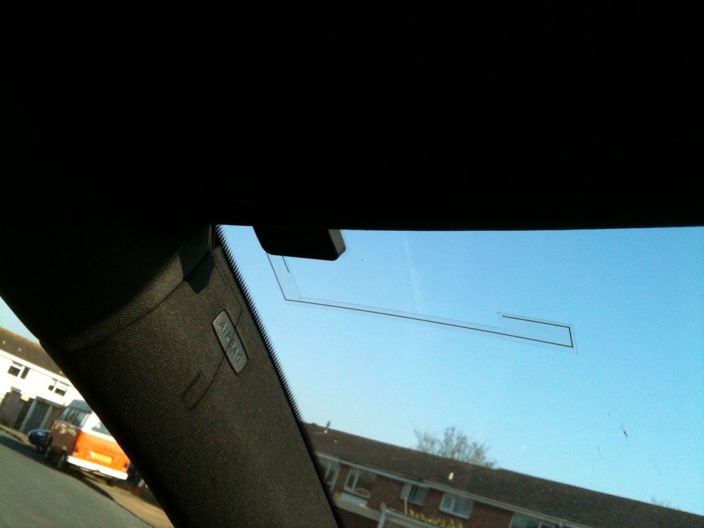

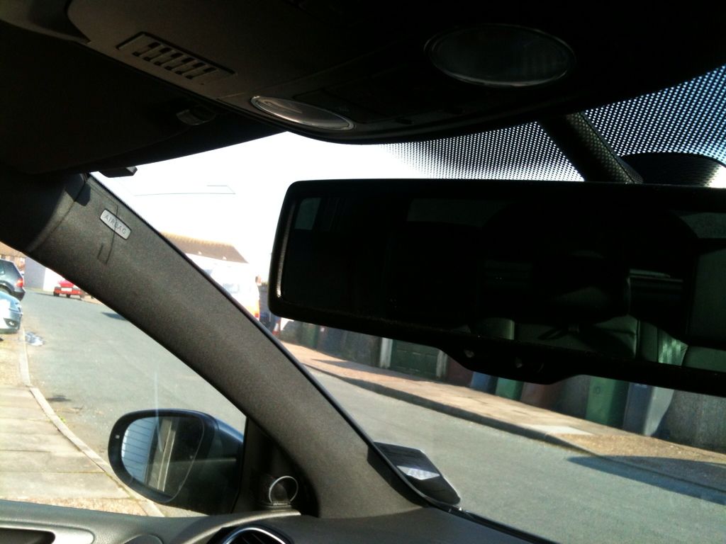

I elected to run the ariel in a non recommended position but one that I used for my Pure unit in my other car (which has ok reception).
It is recommended that the ariel is run up the nearside A pillar about two thirds of the way up the screen going by the measurements supplied. I ran mine along the top of the screen so it's more discreet.
Fitting the ariel was also very easy.
I removed the nearside end of the dashboard http://www.my-gti.com/2729 and pushed the cable through with a stiff wire and plugged it into the AutoDAB. I then ran the ariel cable under the rubber seal up the A pillar underneath the trim which can be pulled loose without actually removing the A pillar interior trim. There's enough flexibility in the trims to pull them away enough without taking any more trim off than the dash end panel. If you want to be anal the A pillar trim can be removed but it's not a quick job as the airbag clip can be easily damaged. http://www.my-gti.com/1867/volkswagen-golf-a-pillar-trims-–-removal-and-installation
The ariel was then run a little way under the headlining and tested for signal before being stuck to the glass.

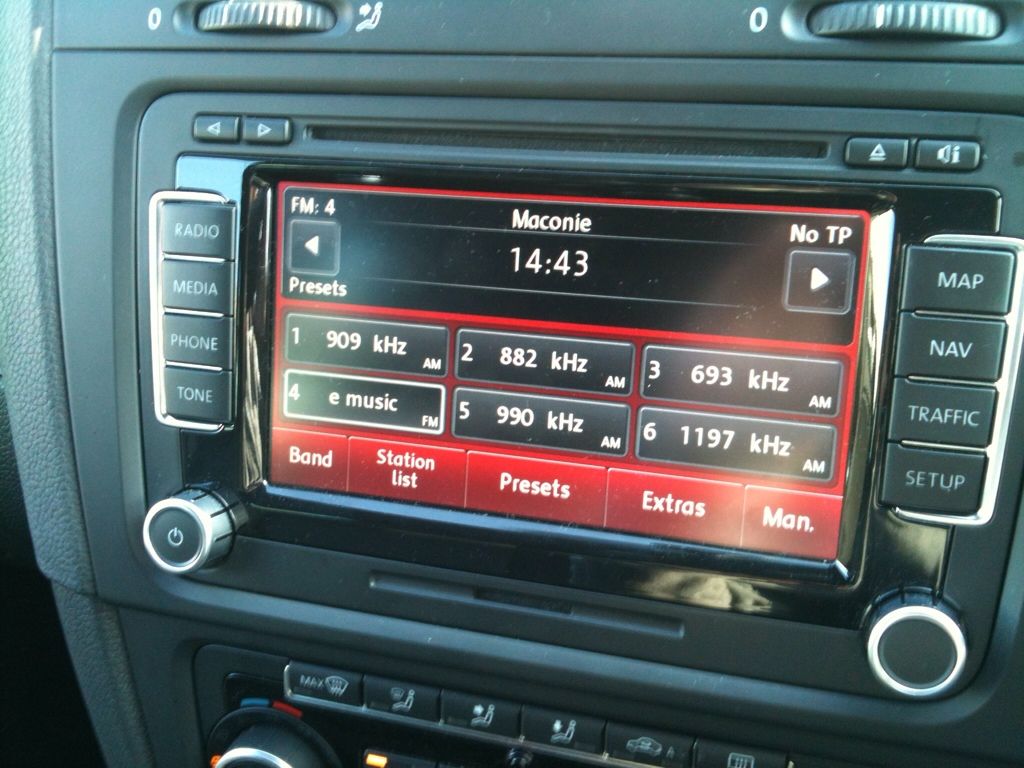

The RNS was switched on and the tuning took seconds.
The signal was good (middle of city) so the ariel was stuck on. Now my hands were bloody freezing and thus I couldn't get the wire bit of the ariel to go in a perfectly straight line without unsticking it several times which would have meant getting fingerprints in the glue which would always be visible so be a bit more careful than I was there. If you have severe OCD this will bother you a lot but I just fold down the passenger side sun visor so I can't see the ariel at all!!  :grin:
Once the roof lining had been manipulated enough to get the ariel 'ground' sticker attached to the bodywork and the cable hidden out of sight the dash panel was refitted and it was back to the radio end of things.
The AutoDAB has various connectors (see link) that plug into the various factory fittings, the original FM ariel plugs into the AutoDAB as does the DAB ariel and thus the unit sends the DAB signal to the RNS/RCD via a cable.

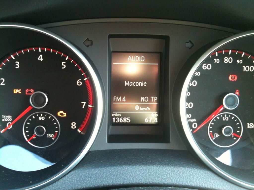

I then spent a little while getting to know the controls which are done through the steering wheel buttons.
In the manual it recommends switching off the scrolling text but I decided to switch it on as I'm childish and like looking at it!! I might switch it off when the novelty wears off but it's useful for checking out unfamiliar music, artist names etc.
