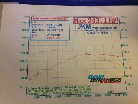

Offline Adam
  • Posts: 5,195
Re: One remap compared to another
« Reply #3 on: 16 February 2013, 07:23 »
For a mk5 I'd say get to Rtech. That's one of my graphs niki has posted and the difference is day and night.
