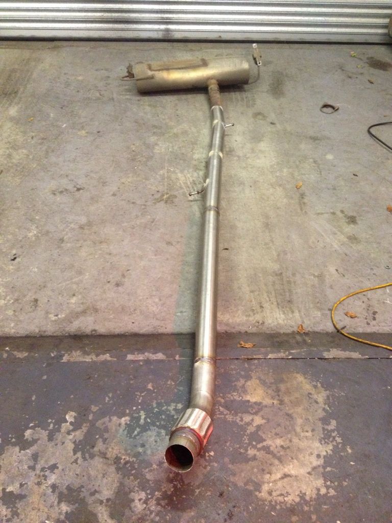

Had a few hours spare this evening so replaced the dented scorpion 2.75" pipework with 3" stainless. It's 3" untill just before the backbox where it reduces to 2.75", this is a tempory measure until Reesy gets another backbox.
 Tig welded by my own fair hands, first attempt at a cat back system, pretty pleased with the outcome.
