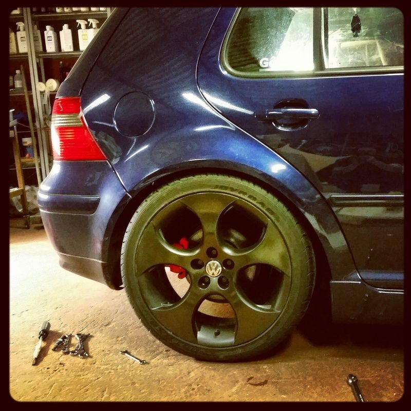

Had a good session on the car last night; fitted the two remaining wheels along with my 15mm spacers and also gave the brakes another bleed though front and back
Unfortunately I've discovered a split in my passenger side outer CV boot so that needs doing before it decides to cover everything with grease....
But anyways here are a few pics of the work carried out before (coilovers, 256mm rear brakes, rear beam swap) and some of last nights efforts
Rear coilovers fitted with new bushes in the rear beam and poly spring tops
256mm rear brakes with proper splash guards, new wheel bearings and new handbrake cables/springs
Shot showing the rear wheels with 15mm spacers now I've centred the rear beam, spot on IMO
Rear wheel on the car
Front wheel off to bleed the Brembos and also showing the 10mm spacers, coilover spring covers and 4motion brake line brackets fitted
Please ignore the widowmaker, it was on blocks as well...
and my split CV boot  :sad:
Hoping to get a decent shot of the car tomorrow once I've washed it but it's sitting really nice now and the brakes have improved massively since the bleed :afro:
