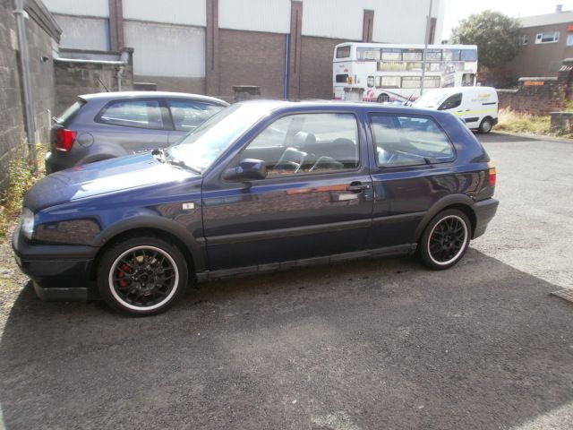

Hi everyone! I'm just gunna plough right in...
I had a 8v Golf GTI before my current one (16v GTI), and never had this much trouble with it, even though it was riddled with rust it never broke down, and only had to let it go because someone wrote it off for me outside the house.
It was okay for about... a week. Then it all just started to go wrong. To cut a long story short, it started to overheat alot; Took him to a VW specialist, £200 later its had a new water pump, a few new seals and clips etc- all okay for about 3 days. Then it starts to overheat, every bloody day, no matter how much water im putting in. Make sure all the oils okay, then i start to notice this gunk. Looks like some sort of fat- this appears on my dipstick and in my water tank. Still going okay, bar having to put water in it everyday, engine sounds fine. (Bear in mind what I do for a living I'm driving all day everyday in him, so isn't exactly getting a rest).
Then today he overheats again, pretty spectacularly, (billows of steam coming from the left hand side of the bonnet, but has done this before) and quite quickly; left him to cool down, went to the shop (left side lights on) come back, battery is dead, clicking away but no starter booting it. Called the AA- he goes over the car, confirms dead battery, but starts to say its all a bit of a coinkydink that its dead after its overheated. Checks my water tank and then announces I've probably blown a headgasket.
Now I love cars, but I dont actually know what this does, all I know from people talking about it, its bad. And Ive had this gunk sat in my car for about 3 weeks. He says hes suprised its still going, gives me the option of driving home, or getting towed to a nearby garage or updating membership etc etc. Im 30 miles from home, so I go against him, and chuck some more water in and drive home. Temperature stays normal, no problems. (As it always is, providing I don't leave lights on and kill the battery).
What I want to know is, if anyone HAS blown a gasket or has seen one, is that whats wrong with him? And if it is, is it worth getting fixed?
I just seem to be having problem after problem and as much as I love this car it's getting beyond a headache and a temptation to give in and get a pantsy fiesta, or something thats reliable. I know he's old, but my god my old car wasnt this much hassle and he had filler in him and opening the bonnet made some guy at the garage want to cry! I dont know if I'm expecting too much for him and should just let him go to someone who isnt racking up the mileage and can love him for the old codger he is. Any help/advice will be much appreciated. Thanks!
