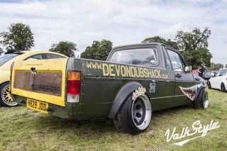

Hey guys. I'm looking into doing a lhd conversion on my mk1 caddy works promotion truck, to tie in with the US theme.
Has anybody converted either way? I need to know what parts are different, etc. I know the rack is the obvious one! Can the column and pedal box be utilised still? What brake servo could I use? Any help much appreciated.
Here's my truck btw:
