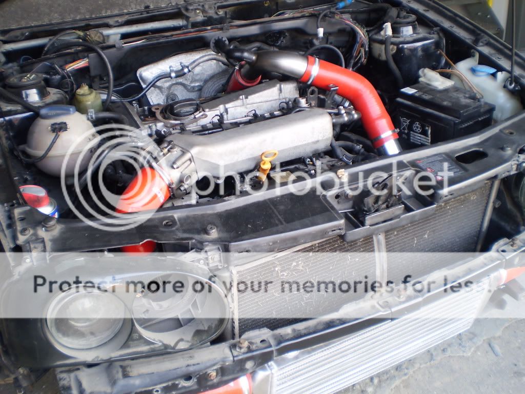

Any pics of ur install anywhere??
Offline madmanmart
  • Posts: 938
Re: Intercooler Pipework (AUM K03S) - 2.25" or 2.5"
« Reply #8 on: 11 April 2012, 22:43 »
Mine on the mk3 with AUM engine
