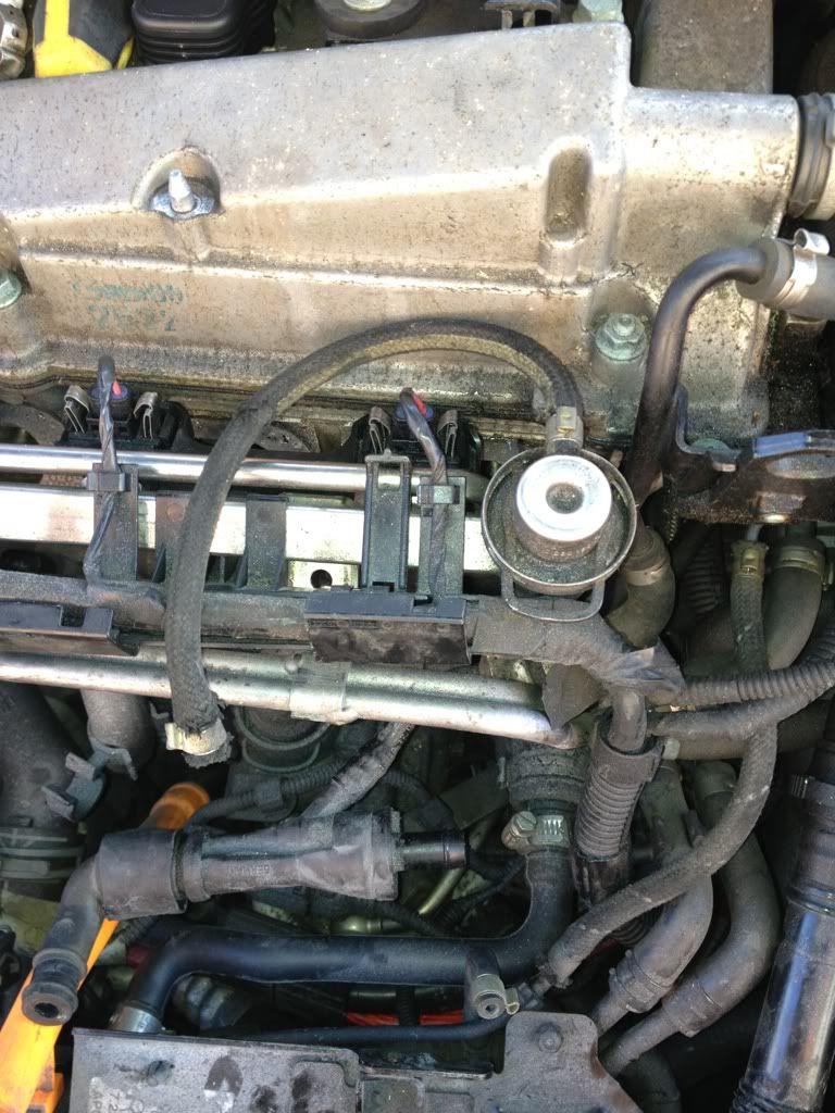

The hose that comes off of the circle thing ...... I kinda snapped the connector pipe off of the inlet manifold what does it do and can it be sorted without buying a new manifold ????

Vacuum to fpr is needed buy a tee and cut it into one of the other vacuum pipes off the manifold and then where u snapped the nipple off drill and tap it out then get some jb weld and use the jb as a sealent and thread the bolt into the manifold

So it would be easier to get a new manifold then really ???

by looking at the pic there seems to be two things disconnected.. could you give more of a descritption of the part you are refering to?..

That loose pipe from your FPR (circle thingy lol) should go str8 into the bottom side of your intake manifold. AGU engine anyway.
dunno what that black thing is thats diconnected tho

« Reply #9 on: 12 December 2011, 14:03 »
It was the hose with the braided bit wrapped around it which goes to the tiny nipple things under the manifold ...... Luckily there was a auq manifold local and the scrappy kindly let me take it for free aslong as i fixed there alarm, 2 fuses and a new battery 5 mins of my time for being heavy handed in the first place lol so not to bad now ive just got to re polish this 1 but its seriously pooped so i might get some one to do it. Cheers for your help though people !!
