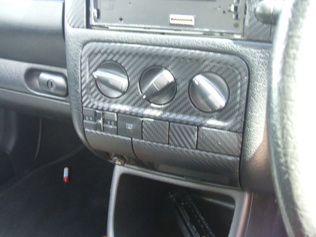

« Reply #6 on: 09 September 2011, 23:28 »
my heater pannel lights just stopped working a few months ago so i just carboned all of it lol. needs the chrome knobs though.
got the locations of dials memorised lol.
sorry for bad picture.
