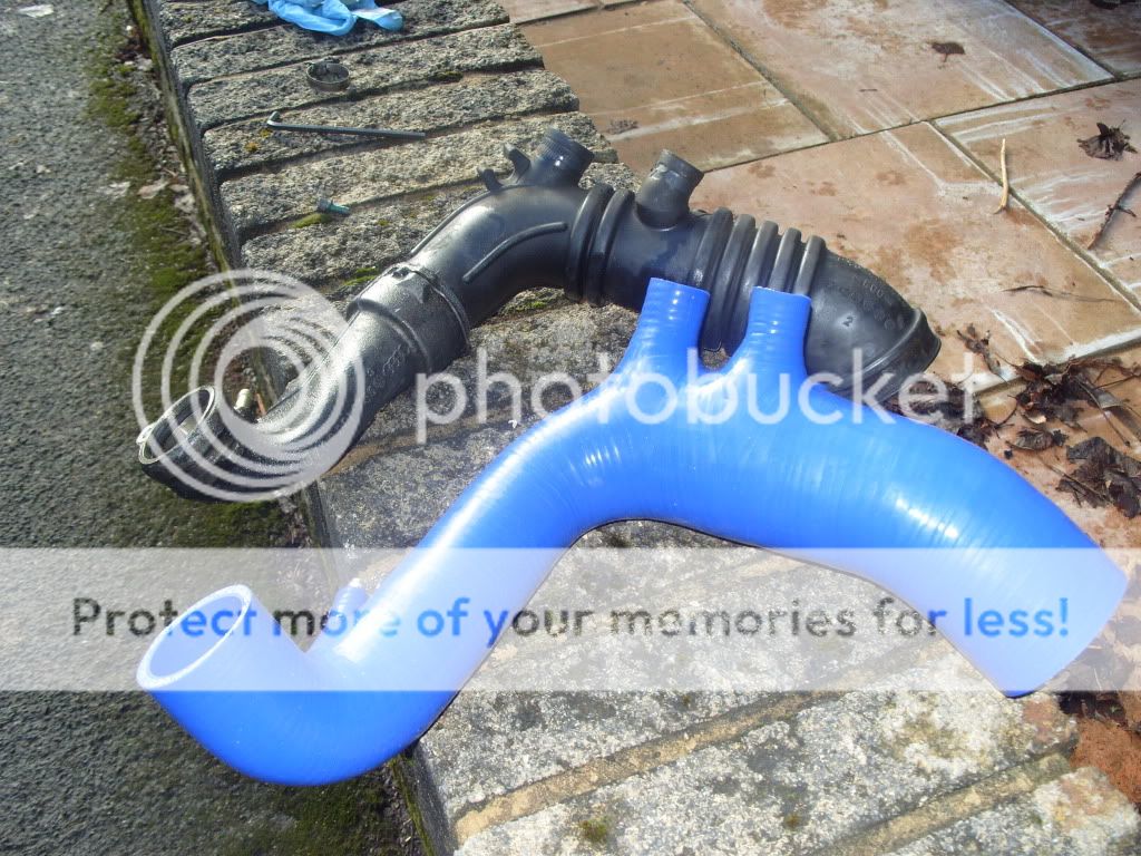

this was mine AGU
was longer but still fitted fine

« Reply #6 on: 08 June 2011, 22:26 »
like the 1 in my pic above  :undecided:
