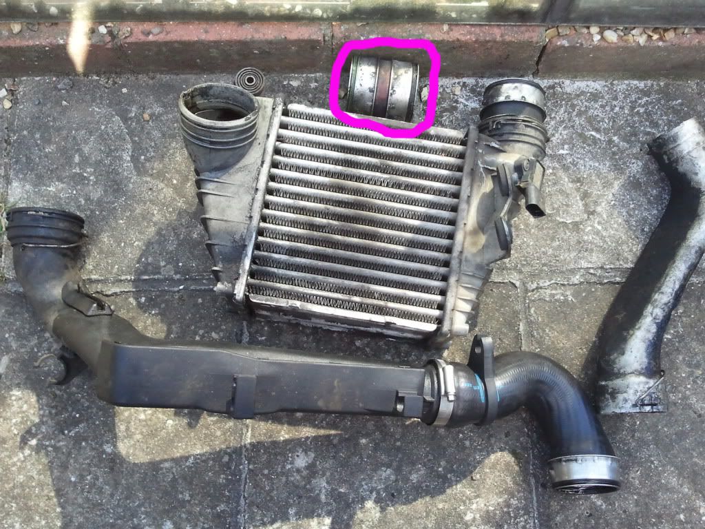

Hi guys,
A few weeks ago I had a whooshing noise coming from the drivers wheel arch whilst driving. I got in there and saw the the pipe between the pancake pipe and intercooler wasn't attached fully. Fiddled about with it and thought I had sorted it. I've now got the noise back so I need to replace the section of pipe. Can anyone tell me a part number and possible price for it? Also could I just use some silicon hose and jubilee's to replace it?
Here's a pic to show the bit i mean:

I had the same problem, but mine would loss power and blow black smoke, i used a jubile clip and it has done the job, still get a wwhhooosss noise from that area, and i get to hear the waste gate chatter lol

If you buy from the dealers make sure you buy some new clips for it.
