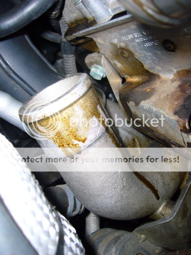

Turbo outlet before test
I would say that has been leaking.

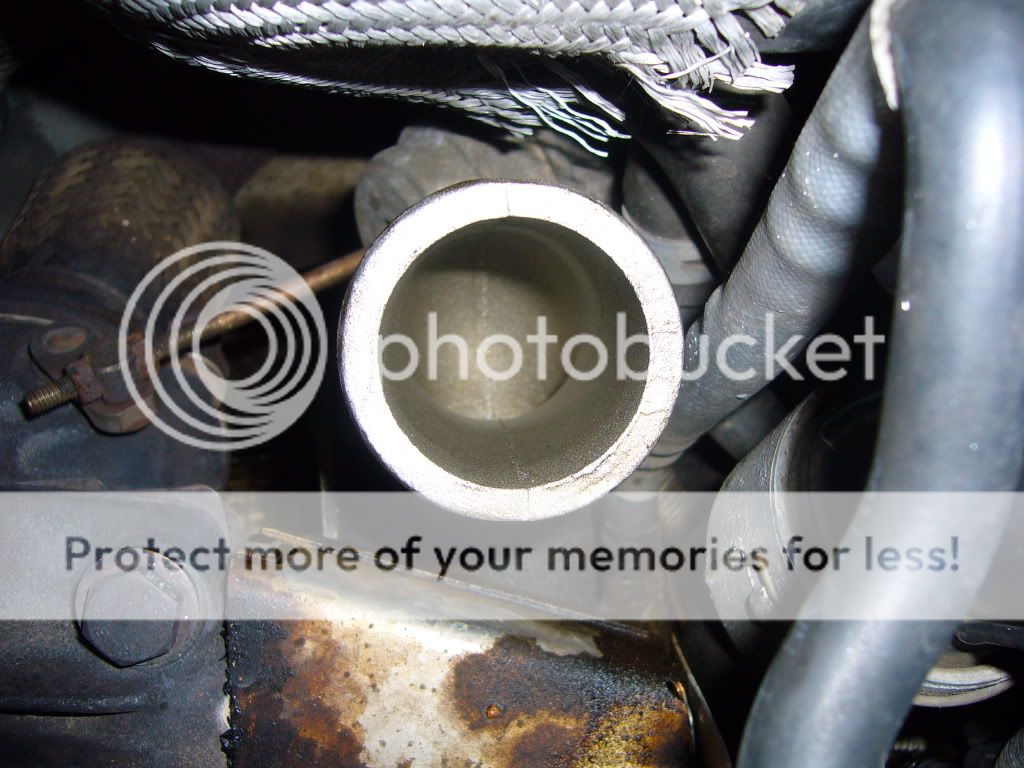

View inside turbo outlet

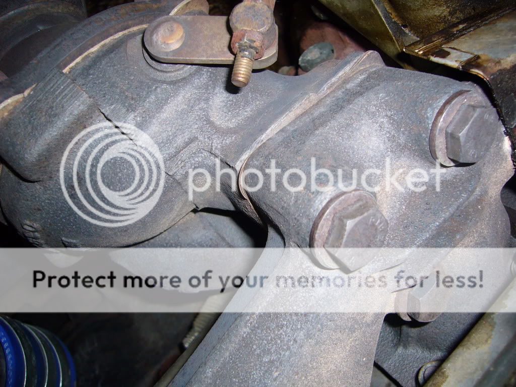

Turbo gaskets, look ok.
