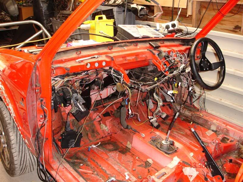

The dash, front carpet etc removed, ready to pull loom thru!
[/img]

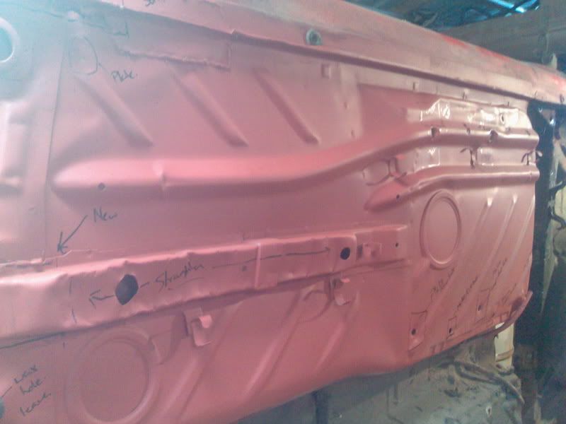

and with that side of the floor pan/cill sorted, i temp preped it(just for somin to do as i had a hangover!! :sick: :embarassed: )
and red oxide'd up to help keep the gremlins at bay till the spray booth!
i then set about stripping the old underseal off the wheel arch aswell, and rust treated it all, and new seam sealer all round
had the other side of the cill to do aswell...
and with that, the whole floor pan is done...check out all the seam sealer runs!!! smelt great!, must remember to open doors when applying this stuff...woooo!(gotta love my welding mask in the background aswell!)

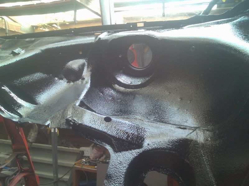

So with all the seam sealer dry, i set about spraying on about 4 coats of stone chip.....yes 4, it still looked abit thin in places so done another coat, just to make sure! :laugh:
So with all the floor pan rust treated, seam sealed and LOTS of stone chip..it was time to paint!

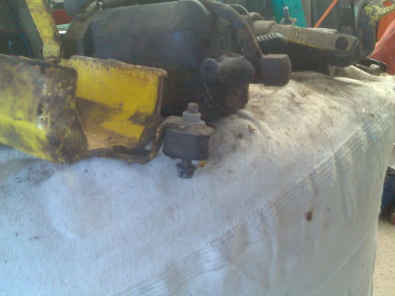

a pic of the underside of drivers side engine mount
all the underside finished! Phew! would defo get it shot blast next time round! But as it was my 1st project i wanted to do as much as possible!
i wasn't that happy with the original front engine mount i made, so i made up a new removable 1 which also bolts up the the bumper mountings aswell as using the old mounting points on the core member(which has also has stregnthening bars added to stop twist etc.

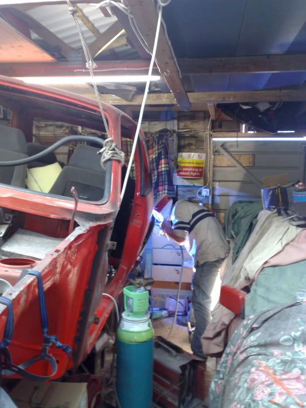

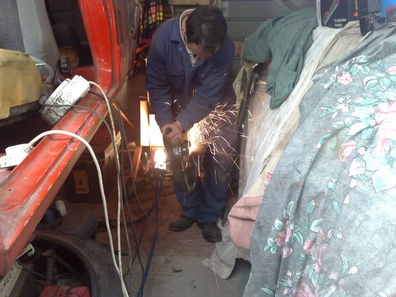

bodywork is all go finally!
inner arch area being prepped etc
outter arch all cut out and ready for new
outter arch
the old...
the new...
horrible inner arch just before cut off
all out and ready for new
busy with the welder..
