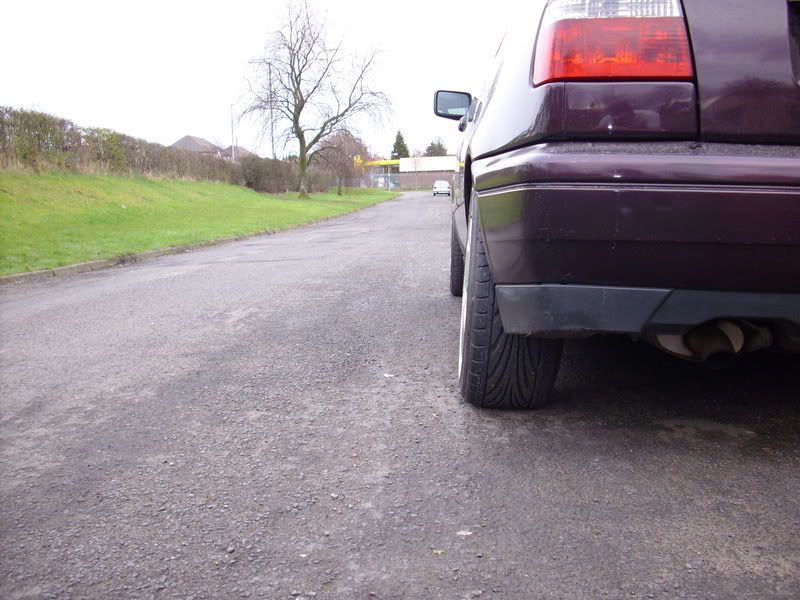

fitted them the way phataz said as it made more sense, as had 22 at the top wiht the settings at 20/20 so going to set it with 18 at the top!!
Thats roughly about 4.75 degress, at a stab in the dark i'd say if you run about 2ish that'd give it a nice angle.
has 1 shim, think its about 1.5 - 2 deg. [mk2 though... obviously]
<--This mk3 is running about 4 degrees of camber, and he did it with some cheap washers from the local hardware store
<--- 5 Degrees of camber.. ohoh
