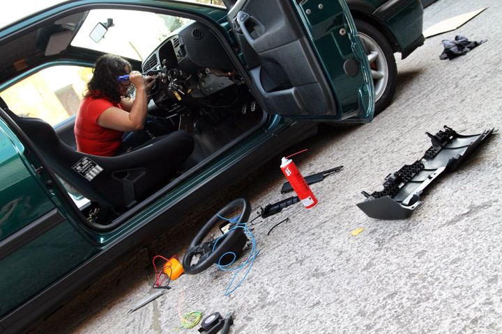

To add info... I got the horn working today with a 'push to make' switch from Maplins (couple of quid), connected the little copper brush (that normally runs against the ring contact on the back of the wheel) through the switch and back to the main body of the steering wheel. Had some 3-core cable hanging around so stripped that down (used the earth and neutral) and added couple of spade connectors from B&Q (£1.05 I think they were) and it works a treat. Just need to find somewhere else to mount the switch other than zip-tying it to the steering wheel... (Yes, plenty of extra cable there to allow steering lock both ways!).

We need pics, and we need them now!  :grin:
Better late than never! (That's what she said?)
My girlfriend getting stuck in relocating the horn...

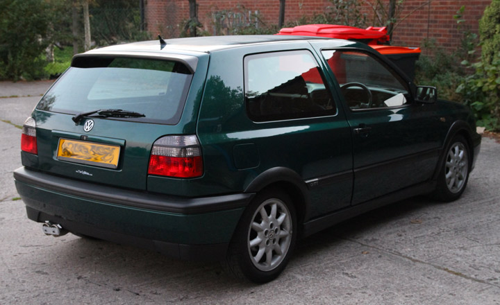

Looks like a nice clean car :afro:
What have you got over your tail pipes though?  :huh:

Thanks - apart from the rust in all the usual places   :smug: Never mind!
Ahh I bought a sound meter off eBay to check the noise for track day, but it was the wrong weighting so I made something to muffle the sound a bit... turns out I shouldn't have bothered as on the correct scale (A-weighting) it's under the limit! Don't worry that super bodge has been removed already  :rolleyes:
