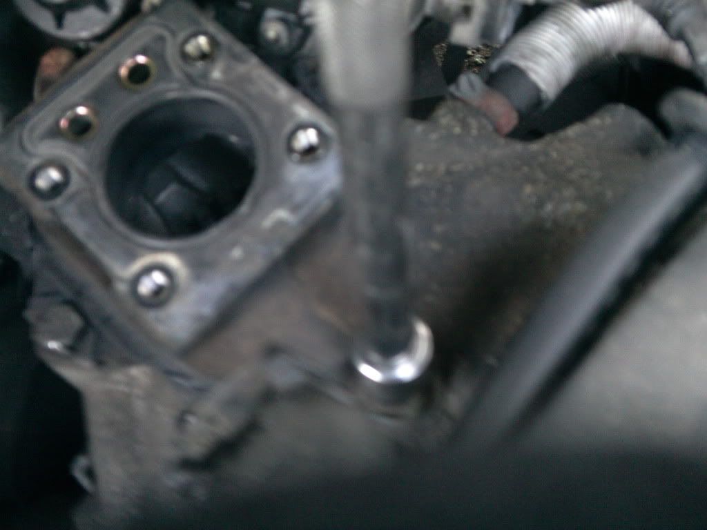

Then remove these three 10mm nuts:
This will leave you with this:
Blurry pic is blurry.
There are four 10mm bolts undo them. Then there are two connectors you want to remove and a tube clipped to it, remove it. Ignore the two pipes next to eachother on the right hand side, they are fiel pipes, leave them on and just move the whole lot over. Take off the throttle cable, pull rubber bung up then un attatch metal cable.

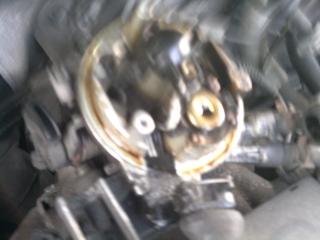

You will see this:
See the cracks? Flames.  :evil:
Undo the four nuts on that and it will come off with a pull (I used a flat blade screwdriver):
