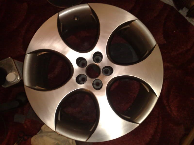

I started with 180, then 320 then 500.
I've tried to keep sanding so it kinda looks like the diamond cutting pattern (you can just about see it in the pic)
I think you need to take it right back with 180 as it sounds like not all the lacquer has gone. I'll warn you it took me a while lol
Not lacquered the wheel yet as I want to get the tyre on there first then pop it past the beads once sealed
