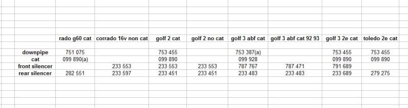

I'm trying to find a bolt on solution that doesn't require any modification to replace my 16v downpipe (other than a standard 16v downpipe) and i think i may be on to something.
I have made the following from info found on the Bosal website:
As long as i'm not being a complete cretin, the above shows that (in theory) a mk3 2e downpipe and cat (therefore a decat pipe too?) should bolt straight up to a mk2 manifold and front silencer?
If anyone has used the above or a similar setup, please let me know if it did bolt straight up.

any MK2/MK3/Corrado 1.8/2.0 8v/16v 6 bolt downpipe will bolt up, just a question of getting it to fit to the rest of your system.
Corrado KR uses identical downpipe to yours, 9a & G60 uses a cat, as do 2.0 8v/16v MK3.  Downpipes on the above are all pretty similar in shape, just get a cat bypass to suit and you should be good to go. I know early Rado G60 downpipe + cat bypass will work as they use same exhaust as MK2 G60 which is also same bore as 16v MK2.  MK3 ABF dp+cat bypass also works.  Not sure bout later rado g60 and 9a,  different part numbers for the zaust system on those to MK2. I imagine it would work however.
Not 100% sure about MK3 2.0 8v either but I'm pretty sure it will also go on, just use an ABF cat bypass as the 2e one I believe is smaller bore at the other end.  Could be the same and its the front silencer thats a smaller bore tho

I think i've cracked it!
The early mk3 8v gti (up to late 93) has a different exhaust setup to the later mk3s when it comes to the cat and front pipe, and it appears that from late 93 the 8v, 16v and vr6 all used the same cat, which from what i can tell is 20mm longer than the early 8v mk3 (and therefore the mk2 16v cat).
So based on the above, i need an early 2e downpipe together with an early 8v decat. Unfortunately, the decat costs more than the downpipe, and it's going to come in at around £130-140, plus gaskets and nuts.
