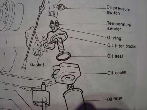

New oil filter bracket has just been delivered and i need a new gasket and seal to fit it. I have a 1989 Mk2 GTi 8v
From the pic i need the gasket and an oil seal. Looking on gsf i think the oil seal is:
11740 OIL SEAL-CAM/INT/CRANK BQ  G2 1.8 8v F.Inj 8/83 >10/91. Sound about right?
The gasket i cant seem to find on the website (might be called something i don't recognise). Any idea which one i require?

that is the oil seal for end of intermediate shaft cranck and cam,    try looking for o ring

pretty sure it this:
11642  OIL FILTER HOUSING GASKET    General Use. Most 1.5-2.2 Engs.    0.80
and this:
15498  SEAL FOR OIL COOLER    G2 1.8 8v F.Inj 8/83 >10/91    1.75
edit: and unless its new, recommend a new oil cooler too:
15499  OIL COOLER    G2 1.8 8v F.Inj 8/83 >10/91    34.60
