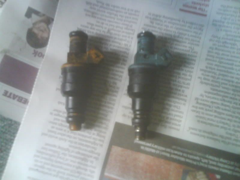

When I got a new head recently the fuel rail and injectors came with it. The fuel rail has the same part number but the injectors are different. The ones I was using are yellow and the other ones are blue!  As you can see from the picture, they are different lengths
Yellow 037906031A
Blue 037906031C
Anyone know which ones are right for a 88 8v digifant?
Also, does it make much of a difference getting them cleaned? Is it worth the £40 or whatever it'll cost?
cheers
Steve

Going on what i read in dave walkers workshop in ppc mag cleaning them makes them flow more equally but actually slightly reduces the flow from them
I tried both the part numbers in etka but none of them came up
Just had a quick look on etka, part numbers for a 88 pb fuel injector are listed as
037906031P
This then supercedes to
037906031R

I reckon you want the yellow ones.  Those are the PB ones I pulled out of the GTI head I ran on carbs.

both are PB injectors, use whichever look best I suppose, or use your old ones if they're known good
Volkswagen MK2 digifant = 191.8cc/min, Bosch 0 280 150 757, VW 037 906 031A
Volkswagen MK2 digifant = 197 or 218.1cc/min?, Bosch 0 280 150 902, VW 037 906 031C

Cheers guys, will stick with the yellow ones then  :smiley: Strongly suspect they've seen a lot less miles than the other ones anyway.
