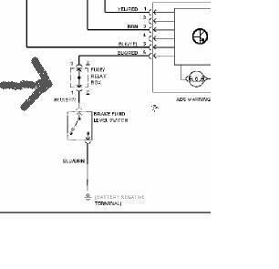

hi
could some one please tell me what the numbers and letters mean where the arrow is pointing on this wiring diagram
thanks
Logged
gazpowells
I live here
Posts: 737
Re: ABS Wiring Diagram
Reply #1 on:
10 February 2009, 21:44 »
sorry you cant really see the numbers in picture
the top is 3 X
bottom 1 C
thanks
Last Edit: 11 February 2009, 07:01 by gazpowells
Reply #2 on:
11 February 2009, 11:07 »
it looks to be showing the pin numbers on the rear of the fusebox, but in a very unclear way, X/3 and C/1.
what year is your car I can get better ones.
Reply #3 on:
11 February 2009, 13:12 »
that would be great thanks car is mk3 gti 16v 1997
Reply #4 on:
12 February 2009, 11:29 »
try zis:
http://vwtech.no-ip.info/downloads/g3abs95on.pdf
Reply #5 on:
12 February 2009, 19:40 »
thanks mate
I think i can we wire my ABS light now
Reply #6 on:
15 February 2009, 20:10 »
problem fixed today
thanks for the diagram
