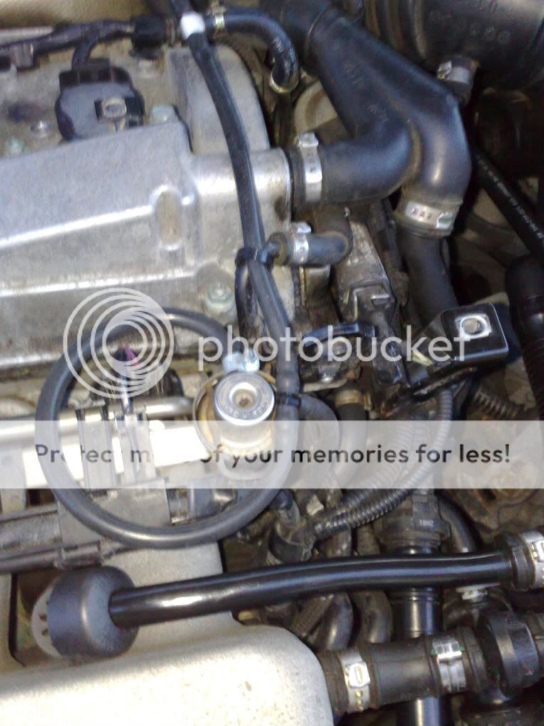

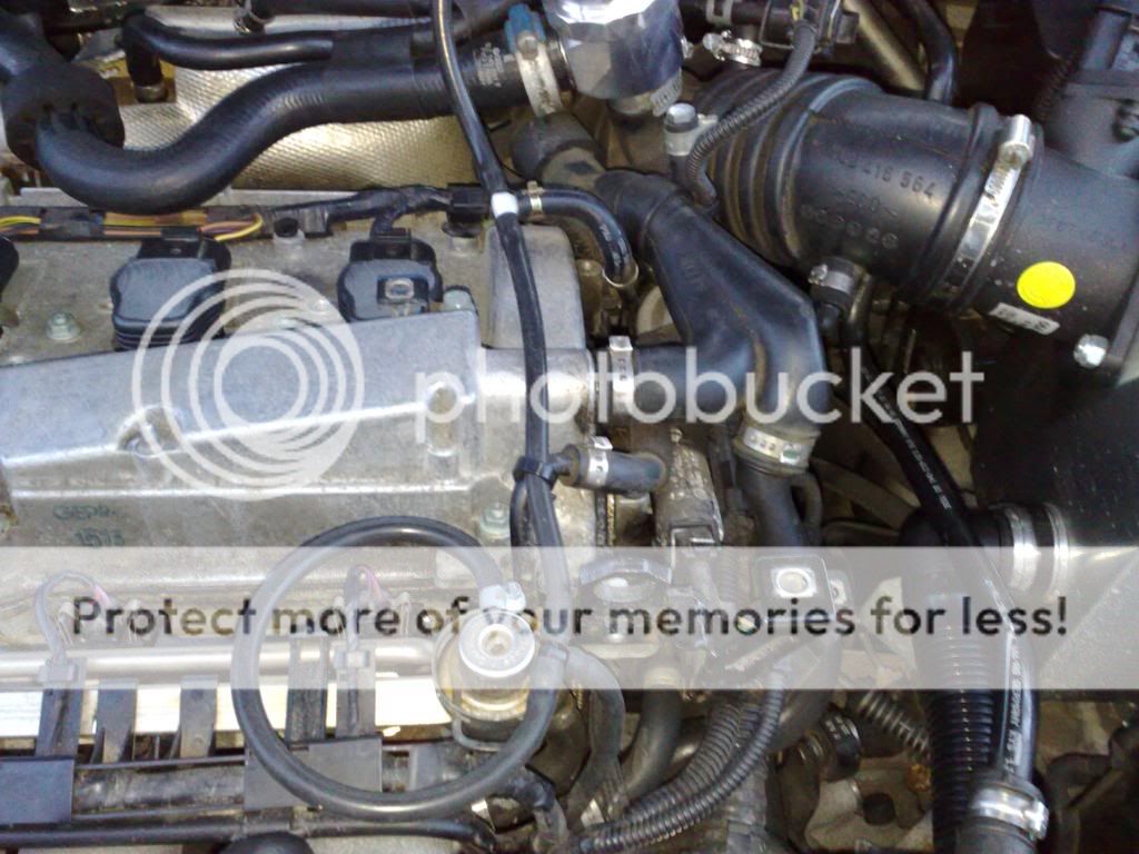

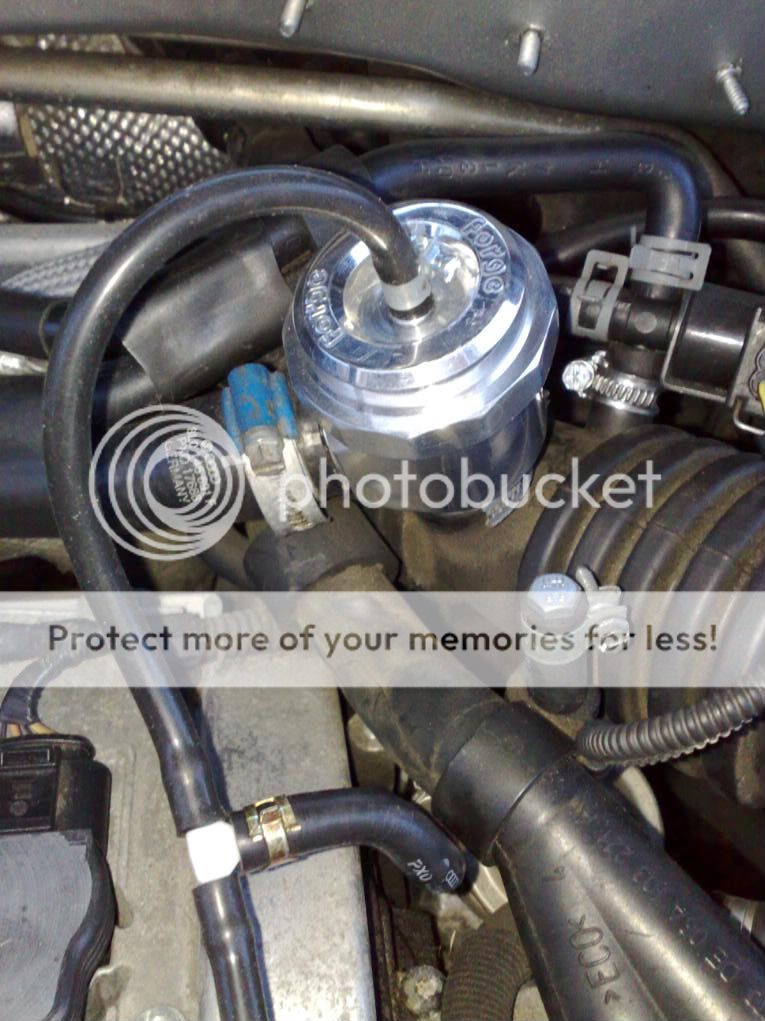

Hi posted some pics awhile back of the n249 mod i did and also to jonnyturbos golf :afro:
well the other day ordered some silicon hose of the "bay" and when i got my climate/interior light issues sorted my hose arrived the same day so decided i may as well get that done to :afro:
the revised look:
Happier with this now  :smiley:

Hi Ian
no worrys mate the n249 mod just basically diverting vacuum from the fuel pressure reg (fpr) into your dv valve having done the basic i decide that the vacuum resovoir may as well be completely removed and another tee piece put into the vac line and the vac pipe tee"d into that the original pipe to the top of the dv valve is blanked off and iirc the vac resovoir is used with the esp/asr function just stores/creates the vacuum from the dv valve in doing the mod its just taking the vacuum straight from the frp to the dv one of the reasons in doing this is to overcome the slight "hesitancy" when accelerating on std/mapped cars in doing this it can/does cure the issue

« Reply #9 on: 22 January 2009, 23:33 »
toph's tip of the day.. be very careful when tapping into the vac from the FPR, make sure everything is TIGHT and secure before you fire the engine up. Leaking fpr vac = lean running = detonation = byebye pistons.
