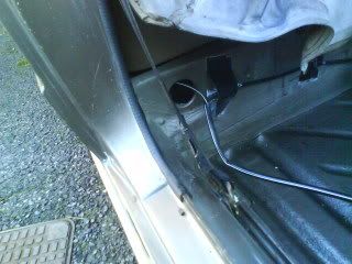

Just went out to my mk1 clipper, to check on her and found the footwells an inch in rainwater!! I know she needs a new roof, got that-just needs fitting! Anyway! The roof's all gaffered up to the max! I did notice that rain had been filling up and trickling into the cabin from this hole. The one where the cable goes thru. Anybody know where the rain would come in, to feed this area??? Maybe the rear winow seals?

look at the rubber seal right at the back of the quarter light, between the glass and hood front lower corner. If this is knackered it'll drop water straight into the boot/back
