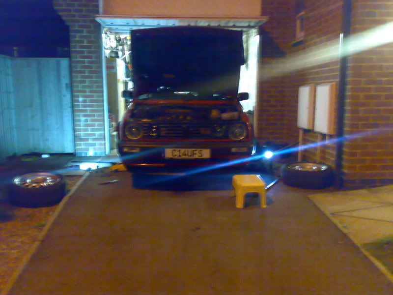

Well what a roller coaster day in the life of MkII ownership
After 4 days of hammering up and down to hospital twice a day ( didnt miss a beat and returned 28.9 MPG despite some spirited driving ) the old girl got a quick check over  :cool:
And its dropping oil like a good un  :cry: and the battery light is shining brighter than the lights at Blackpool, but only intermittently  :huh:. - The bad day.
So after the daughter was safely returned home from her stay with the Not very good Health Service  -I set about tinkering  :wink:
stripped the rocker cover off and gave it all a good clean and new seal . so heres hoping it was that thats leaking and its not from lower down - namely the head gasket.
and it does seem the rear corner wasnt fitted very well at the recent engne rebuild prior to me buying the car  :rolleyes:
next was a good clean down of all the contacts on the alternator and battery etc and so far so good - the lights stayed off  :cool:
So with everything going good - i decided to check on the front  brakes as they has had some abuse and the bad started
Firstly I pi$$ed the neighbours off - didnt notice the time  :embarassed:
then i notice my outer nearside CV Boot has spilt  :cry:- Back to bad again
Old cars - Love 'em or Hate 'em - They make ya Friday evenings fly by  :grin: :laugh:

well took it out for a test run today - leaks still there BUT and its abloody big but
CHECK THE SIMPLE THINGS FIRST .  :rolleyes:
The oil was leaking from the filler cap -    :grin:
 then tracking along the top of the rocker cover then down and back  :laugh: :laugh: :laugh: only noticeable now I had CLEANED the rocker cover as its always been dirty.  :lipsrsealed:
