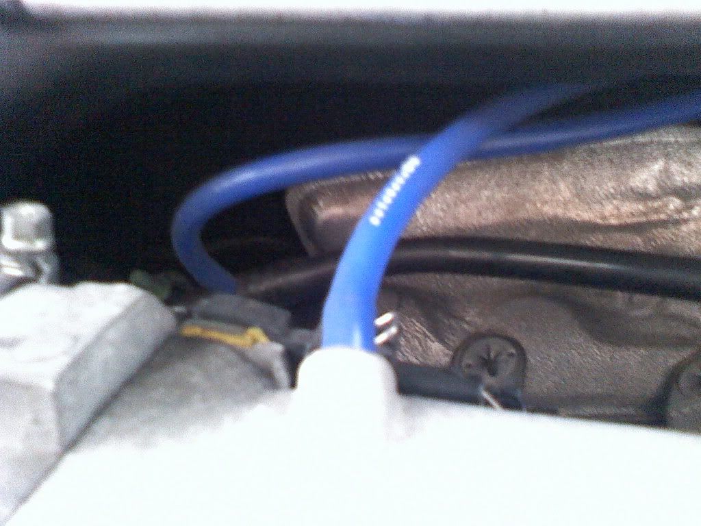

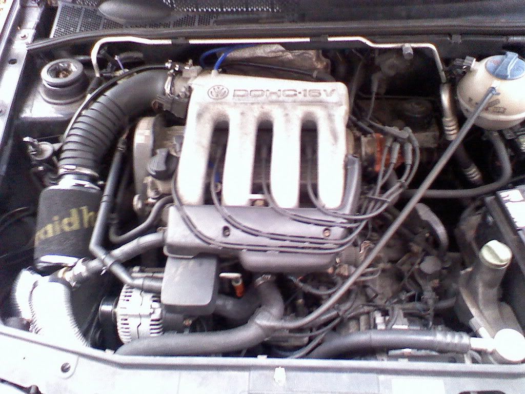

What 3 vacuum pipes would need replacing, sorry if i sound thick, i'm not mechanically minded. do u have a pic of engine bay to show which ones.

Offline DazVR6
  • Posts: 1,705
  • mk3 VR6...FEEL THE GRUNT.
Re: gti 16v cut out
« Reply #8 on: 13 February 2008, 21:29 »
The 3 that you should change are:-
1).throttle body to ECU.
2).FPR (short blue one under intake manifold).
3).PCV to intake manifold (little vac hose near dipstick), although i didn't change mine.
