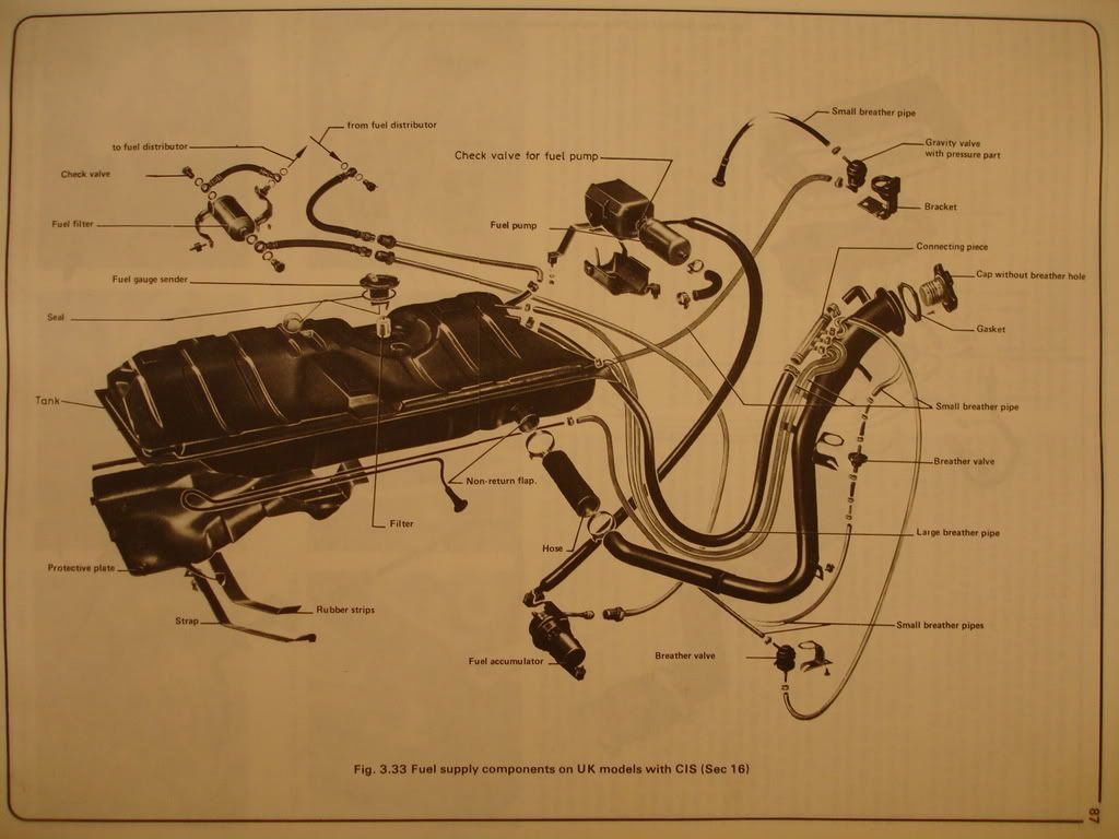

hi im wanting to fit my new fuel tank,accumulator,relay,pump etc any one got a decent pics of this from under the car as took everything off last year,and know got all new bits but struggling to see where everything goes ie pipes to where etc thanks

not sure this will help but it goes tank to pump - pump to accumulator - then accumulator to metering head!

here you go mate hope this may help.

cheers fella superb
