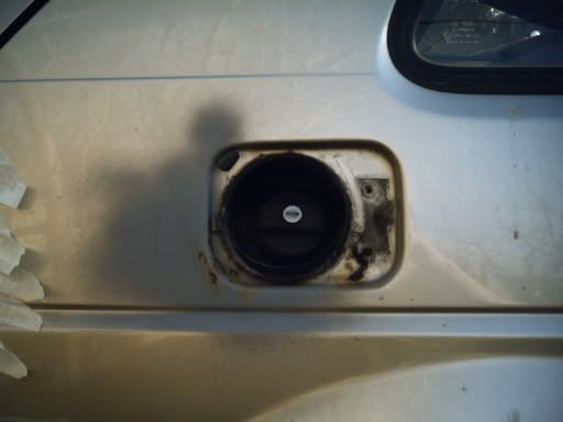

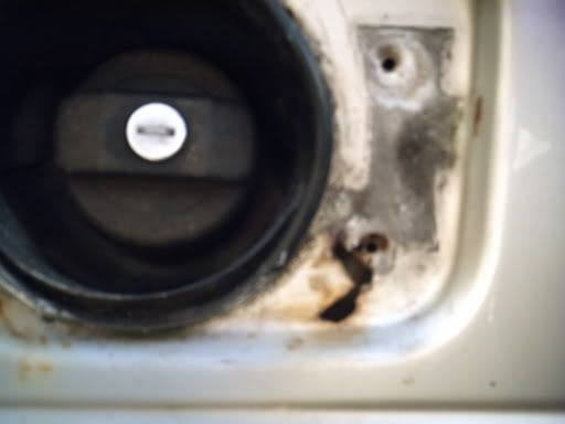

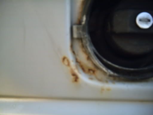

i found some (well alot) of rust round the petrol filler cap.
i was wondering what should i do? should i get a replacement panel and cut the rusty one out and weld in the new one- sounds like a lot of hard work- would have to take fuel tank out, or i should get something like this-

is that primer sprayed all over the place on the last photo?  :shocked:
it depends how long you want it to last for, a whole new panel will stay rust free for the longest, whereas welding in new pieces won't last as long.
If it was me, I'd sand back the rust with some wet and dry and get it really smooth, if the rust has eatin into the metal then get it filled, before putting on some zinc primer and then painting it your car's colour. It won't last as long as the other options but it sure is cheaper, and try to keep an eye out for the rust before it gets too bad next time!!
If in doubt, get it taken to a body shop!  :smiley:

Either replace it or start looking for a new car.
Filling it won't do jack as the petrol will just eat through it, along with the vibration loosening it off, also from the picture it looks like it would need some fibreglassing to cover the hole and to give the filler something to bond too.

A complete waste of time and money doing anything other than cutting out the rot and "letting in" a new peice of second hand panel, it shouldnt take any more than a couple of hours work to get it to the point that it needs a skim of filler, especially if you know someone thats nifty with a MIG welder..
That area of the car goes rusty from behind, where sh!t from the road builds up, grinding it down to bodge it with any sort of filler makes no sense, unless you want to get shot of the car quick!
