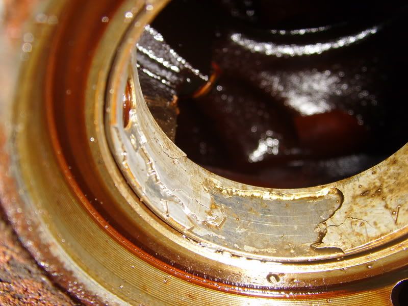

i have a kr 16v destined for my mk1 so i thought i'd strip it and make sure everything was gonna be right before dropping it in!
when i removed the oil pump drive shaft i noticed that the bearing that it runs on is knackered! (broken up and only about half left of it)  it appears to be made from lead and am assuming it just knocks out but i've been looking on vagcat.com and cant see the part even listed?
just wondering if anybody has had similar experience and can shed any light on the matter?

Yes, seen this before, it's sometimes called the auxiliary shaft bearing. The bearing is a press fit and easy to change, remove the oil seal and knock the old one out, line up the oil feed hole with the gallery in the block and carefully using a socket and a hammer, tap the new one in until it is in the correct position. I usually buy the bearings from a engine reconditioner, they are also available from VW.
