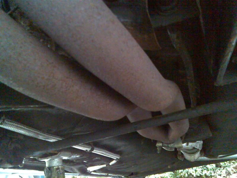

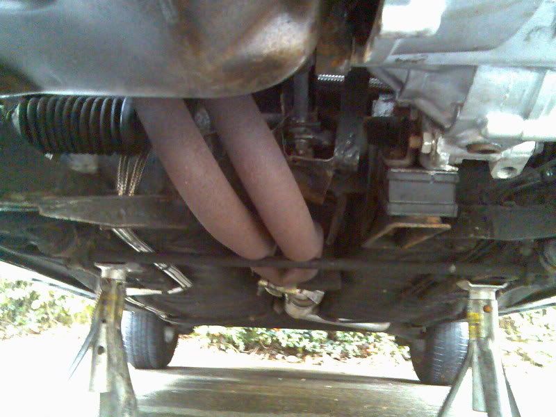

I took a few under the car shots the other day, so here's some of the fitted exhaust

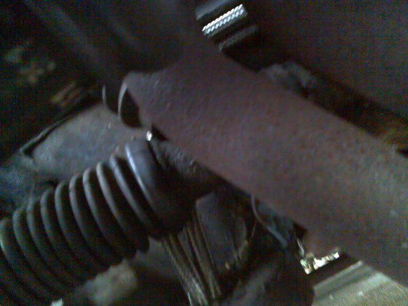

Now, with some exhausts I could mention, you have to heat-shield the steering parts to stop them from melting... unfortunately the one in my loft was in actual contact with the steering rack
This one doesn't come anywhere near the steering gear:-

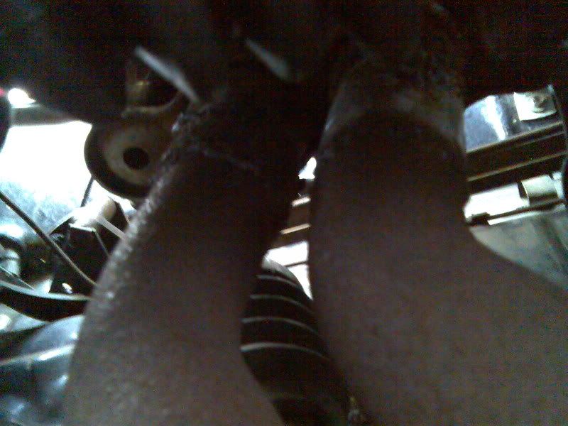

No contact with the Anti_Roll bar here either
It doesn't hit the gear linkage like other's I could mention either
Perfect
