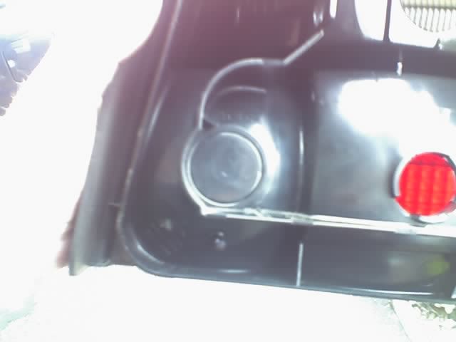

First off, undo the three 8mm nuts that hold the rear light lens on and remove the lens. You will find that the hole for the fog light has a blanking plate.

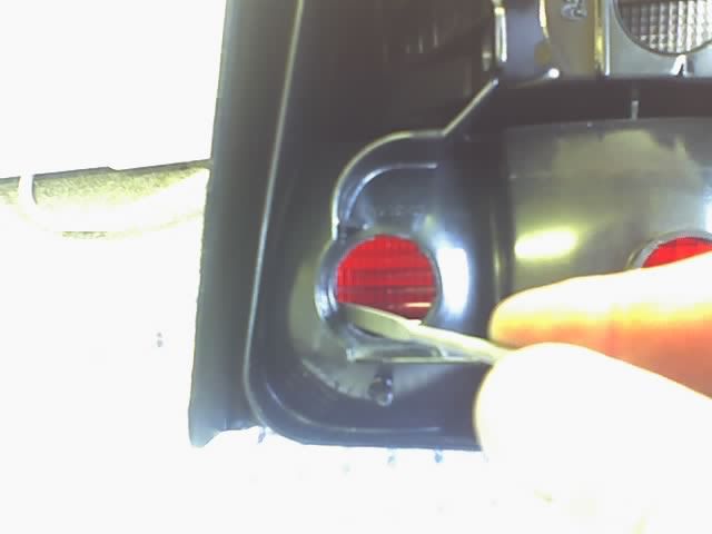

Use the knife to carefully prise down the side of the blanking plate and then, even more carefully, twist the knife until a small piece breaks away. Keep doing this until the hole is big enough to get your finger in.

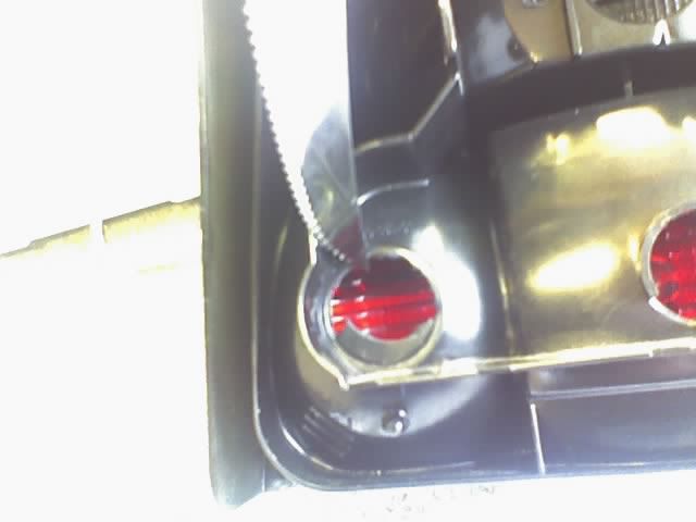

Now break the rest off with your finger so you are left with the rough hole.

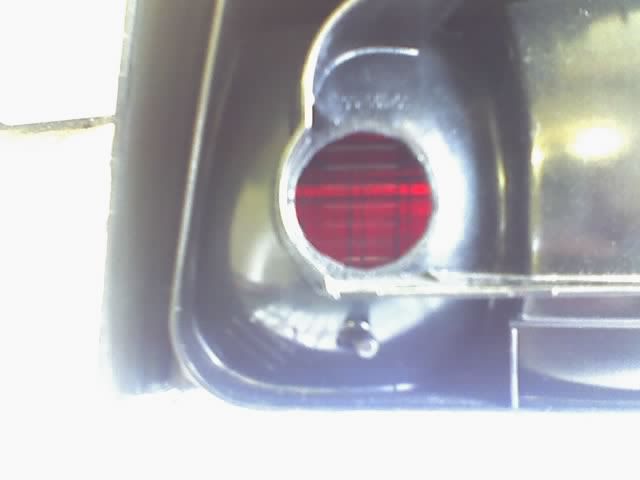

Now neaten the hole with the file until smooth.

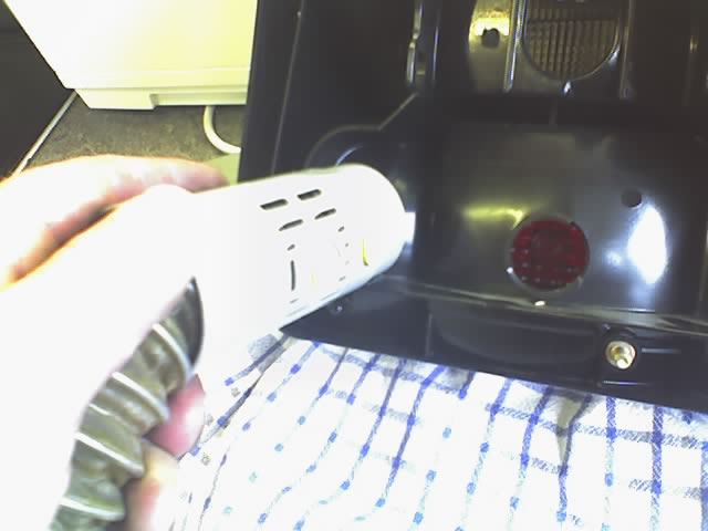

Vacume any dust and debris from the hole.

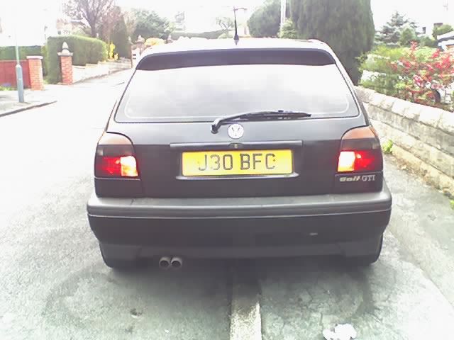

Fit a 21W bulb into the holder, refit bulb holder and that's it!!! Twin rear fogs :nerd:
Its so simple and only took me about 20 mins to do :cool:
