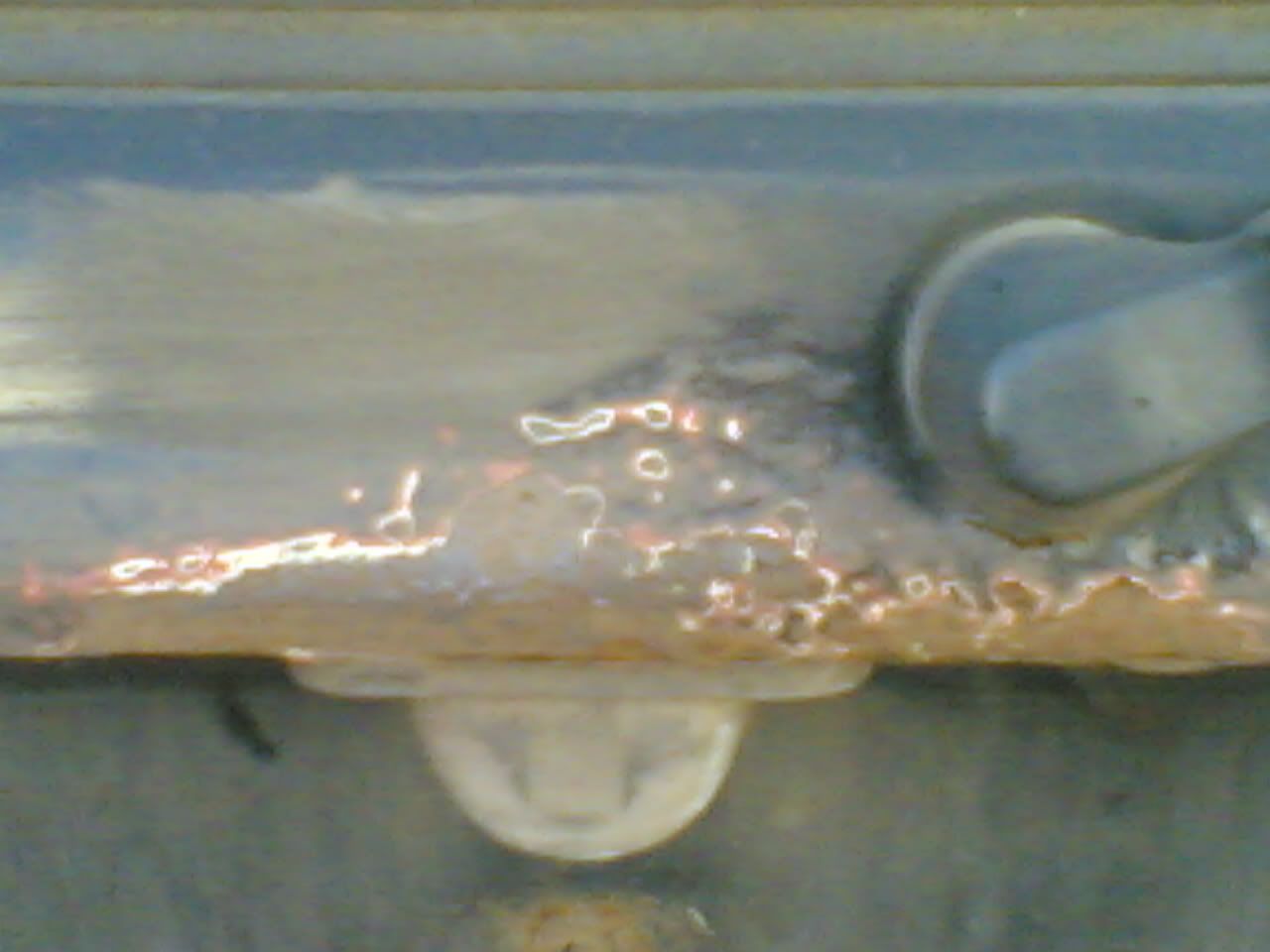

I quickly proceeded and found this under the handle (after an ickle bit of sanding):
as you can see, its not too awful...

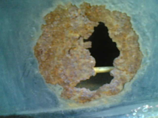

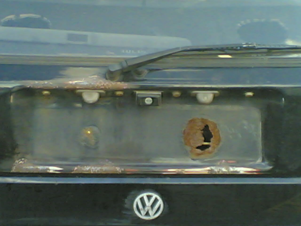

Then I thought, hmm, I'll take off the number plate, maybe its got a little bit there, and I found this staring back at me!!
So. my boot at the moment is this:
Its gone from an easyish bit of surface rust, to a gaping hole, so how could I get this sorted?

p38 and p40 mate... maybe a little bit 'o mesh too...
Really annoys me when I see this, it's cos the dealer insist on using self tappers for the number plates, not stickons or the nice surrounds you always see on german cars....

hole looks a bit large to mesh up to me, and remember that it will be under stress when being opened and closed, which could make the filler crack and the mesh pop out. personally i would get a new tailgate from a scrappy, and get it painted if you cannot get one in the right colour. Might even be cheaper than all the repair stuff.

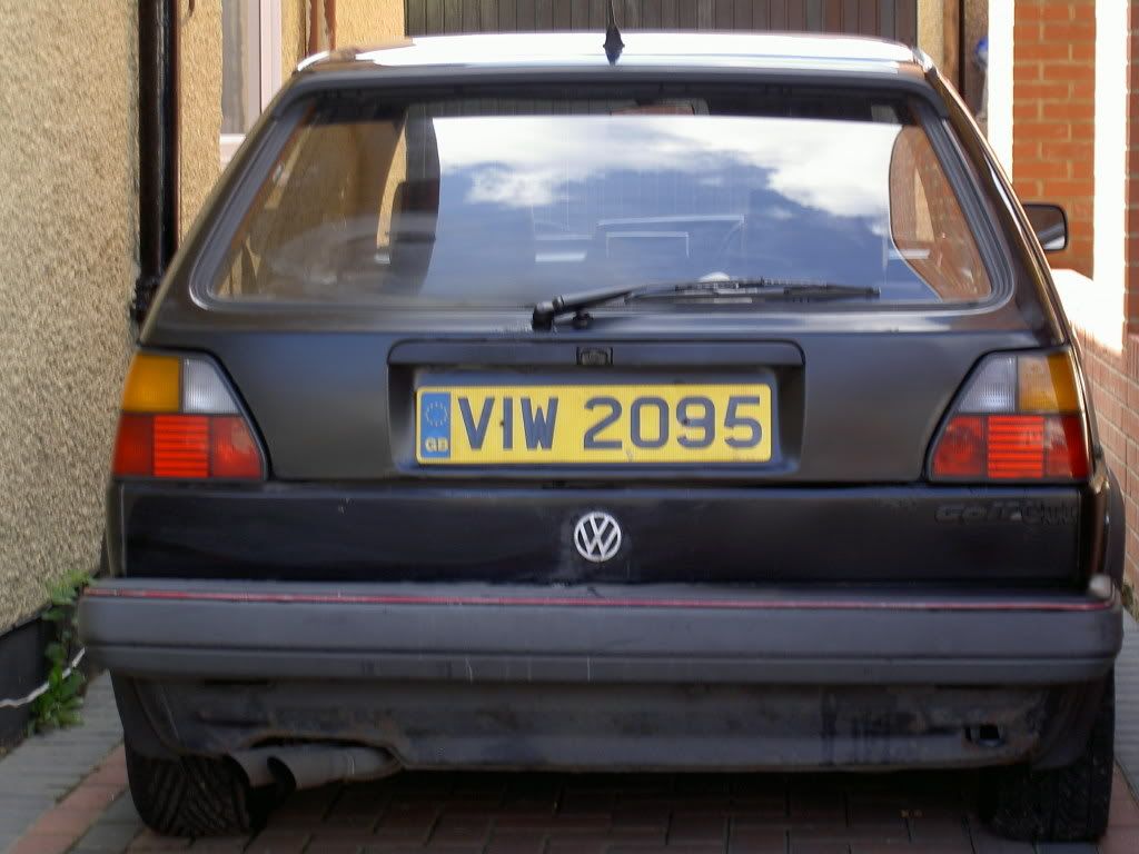

My tailgate now looks like this:
I haven't sorted all the painting, like the actual main paint and lacquer, but I am liking the matt finish on there :grin:
