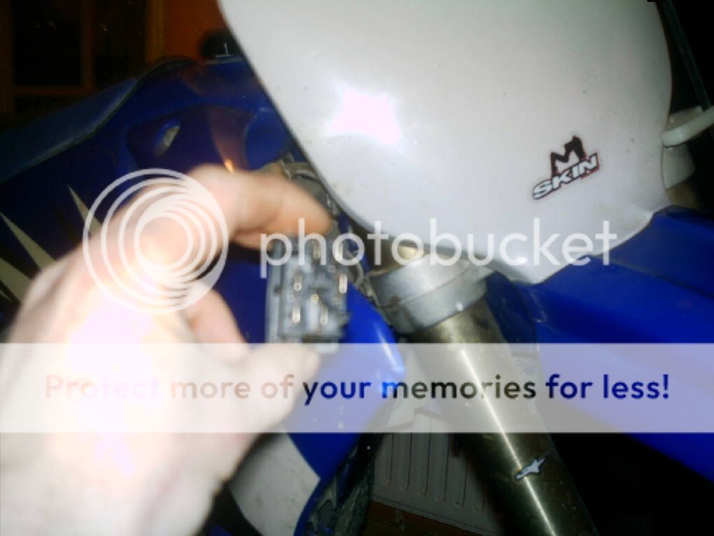

has anyone got the know how to wire a six pin electric switch up i have all wires there but can only get them to work either up or change wires round and down but not worikng together and iv blown more fuses than i can remember
any info would be great

1 - motor power output
2 - motor power output
3 - motor power input
4 - earth
5 - motor power input
6 - switch light power
3 & 4 get power from the relay, 6 does as well from the factory but you could wire this to your light switch if you want it to only come on with the lights. 1 v& 2 then go to the motor you want to control, trial & error is required to get these 2 the right way round

cheers mate worked a treat.
