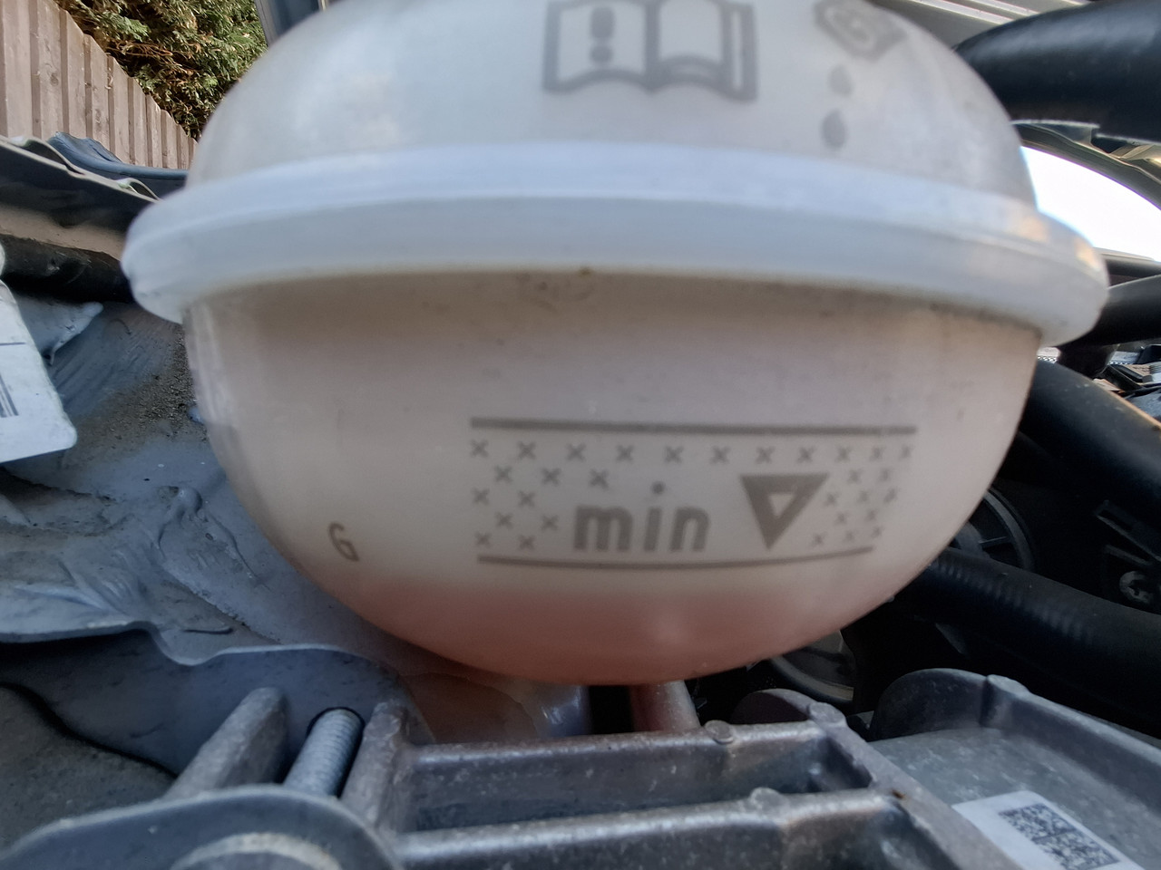

Well I think I jinxed myself. Went to check levels today before a road trip to France and was greeted by this.
Hopefully it's just evaporation and it only needs a top-up. I'm giving it a service when I get back so I'll get underneath and look for the tell-tale pink crust.

Working correctly the system is effectively sealed, so you shouldn't lose any to evaporation.
