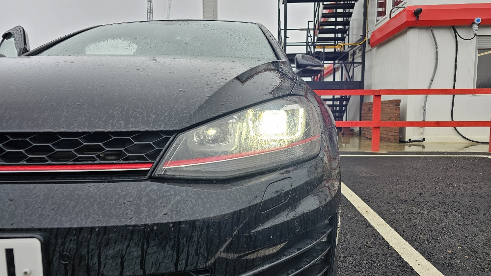

Hiya, I've seen soe Mk7's which have all the lights on in each headlight while mine has the outer light only on - can anye shed any light (bad pun intended) on this?

Golf Rs have the inner U illuminated too, unlike GTIs which are the outer U only.

As above and no you can not make them light up as they have no LED's behind the inner U unless you buy new aftermarket headlight units.

and TCRs
