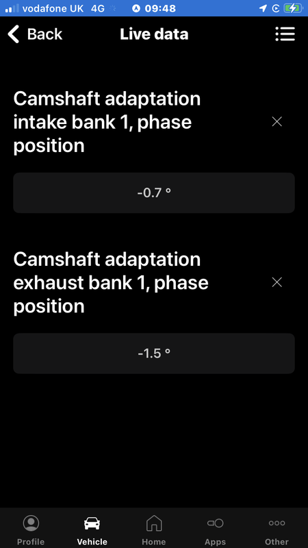

Which one is related to chain stretch please guys

Both, it's reporting the position of both the inlet and exhaust camshafts.
I would say those figures are nothing to be concerned about as I've read the unofficial tolerance is +/- 5 degrees.
That’s great thanks buddy
