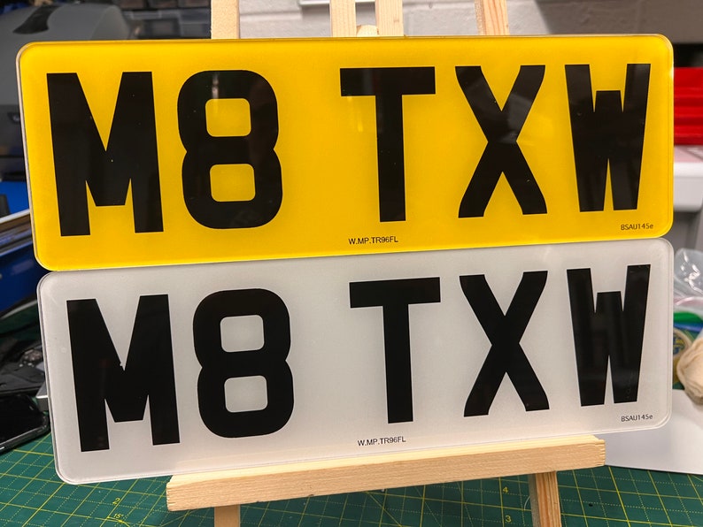

As I only have 5 letters, I wanted a shorter plate like this (Not my plate)

Just a heads up, you don’t need a 40mm border. The requirements are:
  • characters must be 79mm tall
  • characters (except the number 1 or letter 1) must be 50mm wide
  • the character stroke (the thickness of the black print) must be 14mm
  • the space between characters must be 11mm
  • the space between the age identifier and the random letters must be 33mm
  • the margins at the top, bottom and side of the plate must be 11mm
  • vertical space between the age identifier and the random letters must be 19mm
There are a few other things it needs to have to, namely the details of the place that made the plate, and the BS AU mark.

Arhhh even better, thank you Doc.
