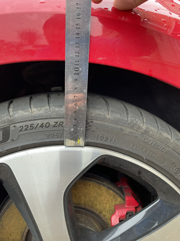

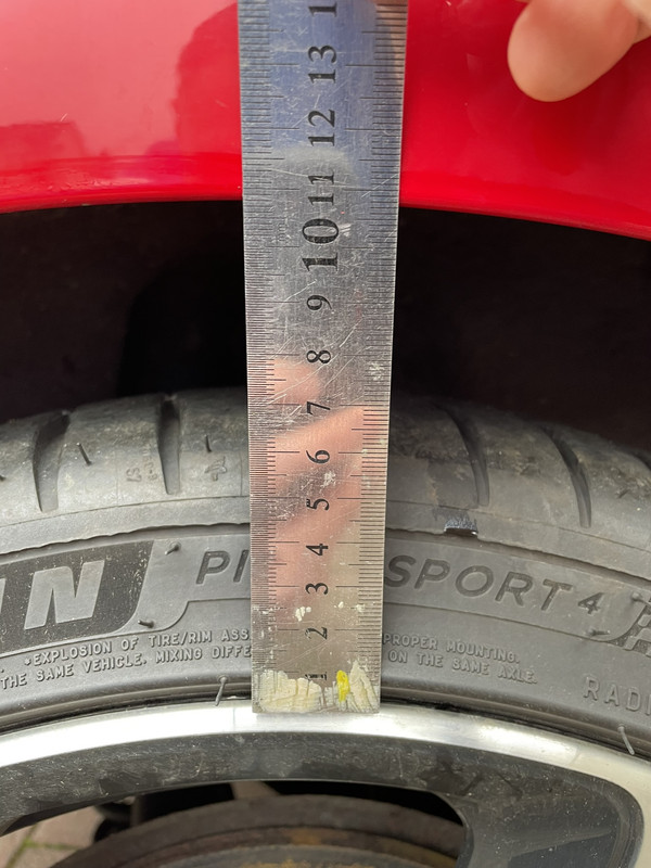

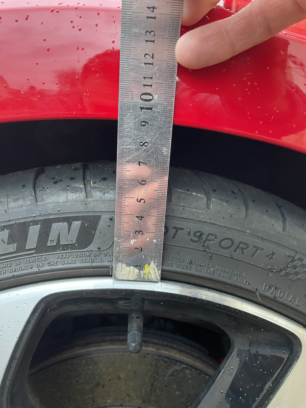

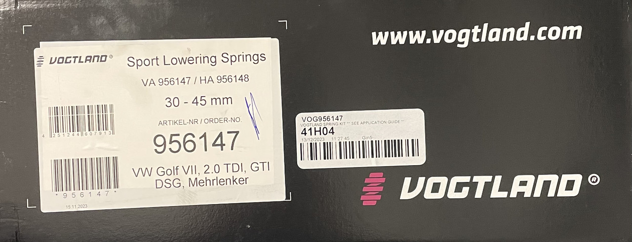

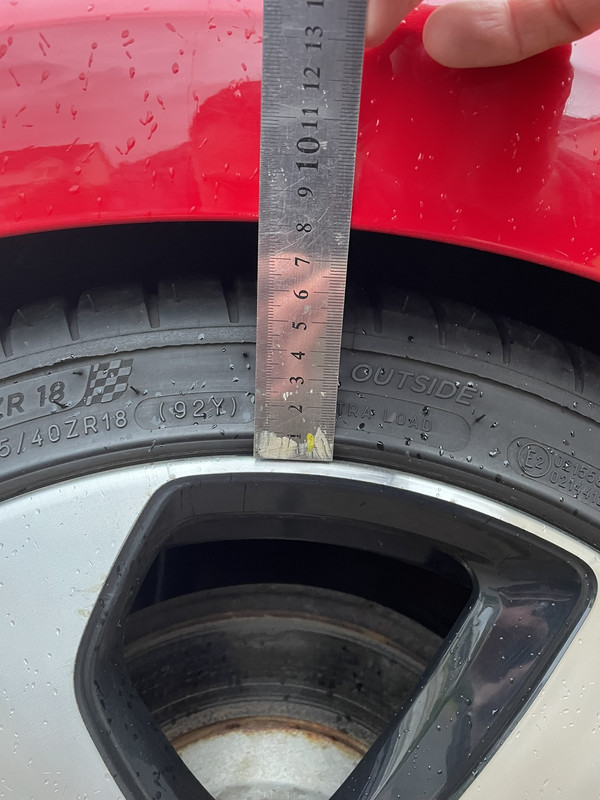

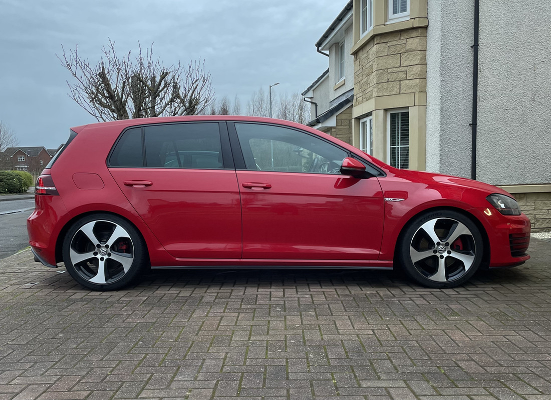

Just a wee update.
I ended up going for the Vogtland lowering springs just to go for something different. I’m really pleased with the result, it’s a subtle drop and the ride difference is pretty much unchanged.
Here are some before and after pics. I did the install the other day and the after pics are taken straight after I finished so it might settle a bit more.
Car on standard springs.
Front dimension before 111mm
Rear dimension before 107mm
Car after install.
Front dimension after 90mm
Rear dimension after 80mm
Kit used.
