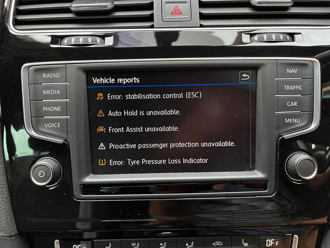

- When I connected the battery at the end, I waited for 10 mins before turning the ignition (probably don’t need to). I got around 7 errors come up quickly. Drove the car around for 10 mins, turned it off and then on again and the errors were no more.

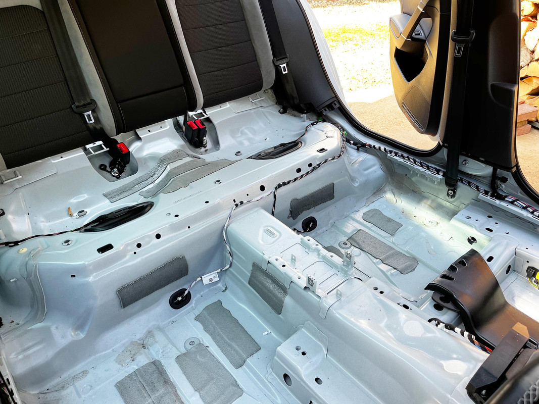

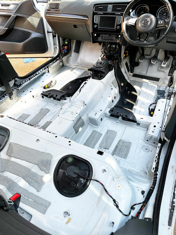

After everything was removed!

Errors when connecting battery
