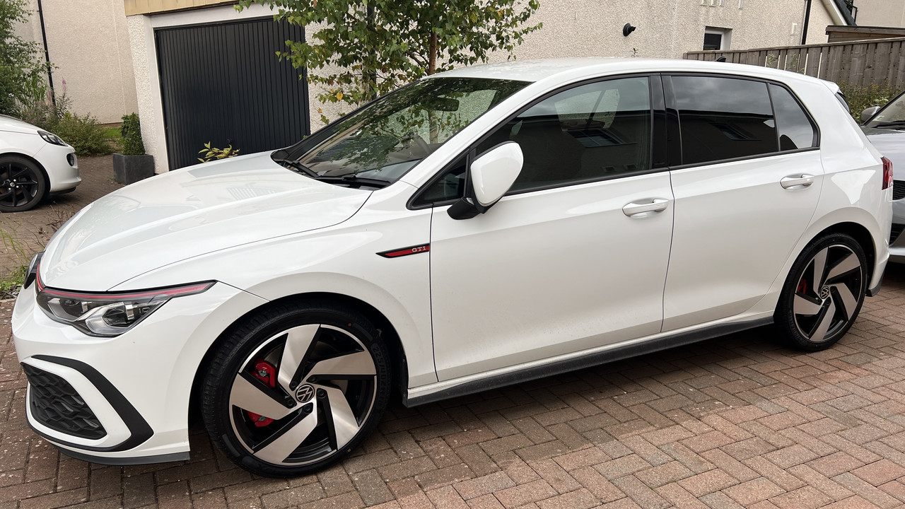

Well, nearly 40 years after a trip to a local cricket match in a friends Mk1 red GTI, I finally bit the bullet and bought my own - a Mk8 in white.  I’m the 2nd owner.
