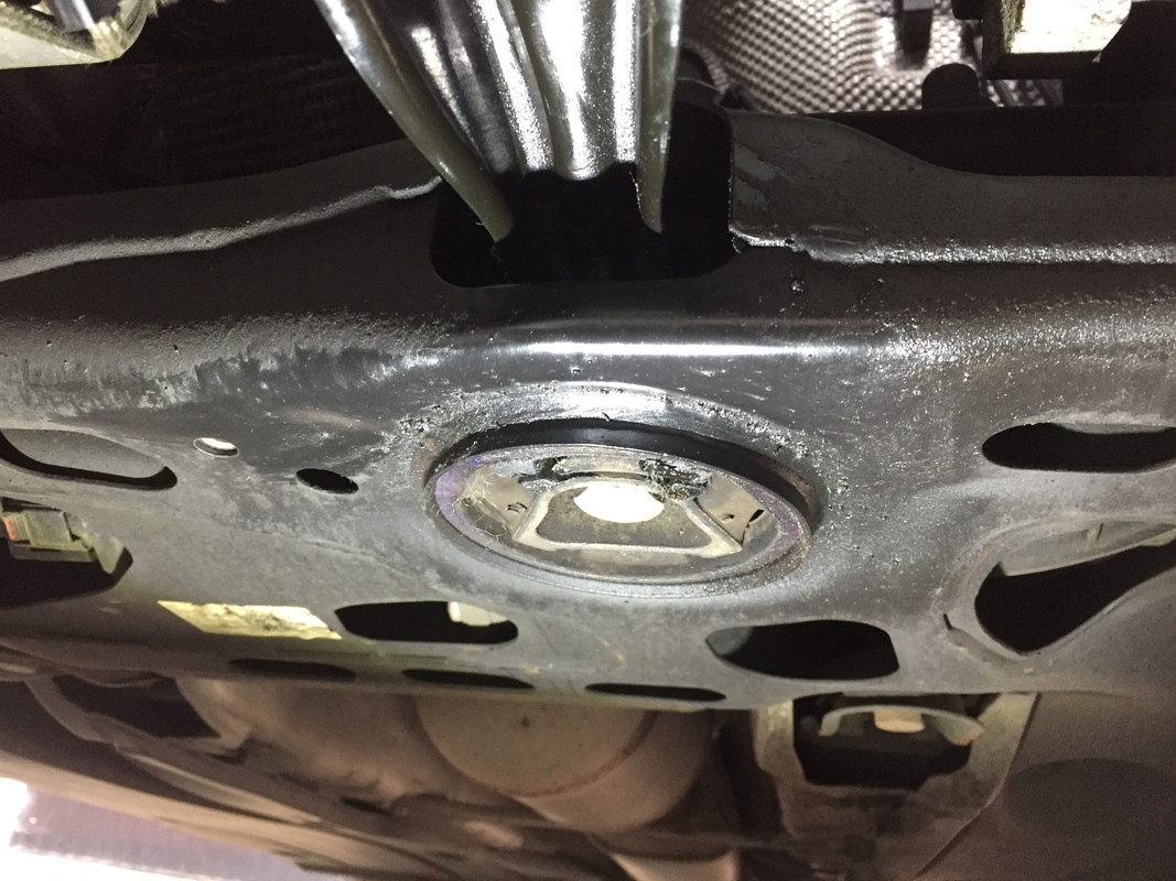

Hmmm....just spotted a dinnerplate-size patch of oil drips on my driveway and it’s coming from underneath the Golf. It’s normally where I park so this part of the driveway is rarely visible (and I never thought necessary to check for oil leaks on a 2.5 year old car).

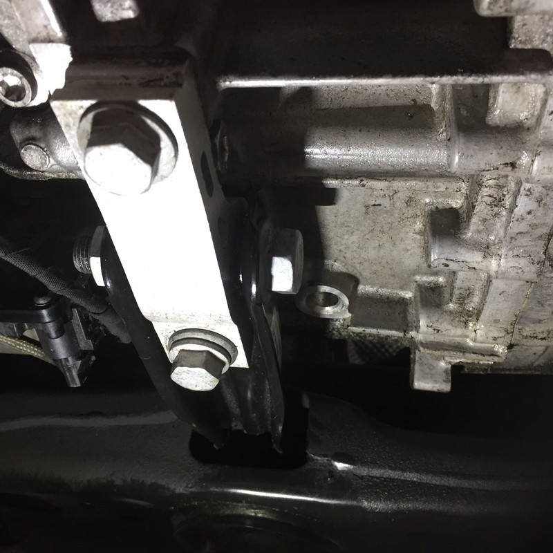

Drove it up on blocks to have a better look. The oil pan is bone dry and likewise the sump plug but the back & underside of the engine block and nearby edge of the subframe are misted with oil to the point of collecting into drips on the 2 large nuts in one of the photos (I’ve wiped these first). It’s not easy grovelling around under the car with a phone and flashlight so apologies if not 100% clear.
Car is a 2019 manual with 15,000 miles. The dipstick registers as full so it’s not an extensive leak but appears to have been ongoing for a while judging by the mess. Nothing was highlighted when I bought the car in February when it was also last serviced.

Smell it, then compare the smell to engine oil.
It may be Transmission fluid which smells very different to engine oil.
It could be a driveshaft seal or could also be grease thrown out from the inner cv joint if the gaiter is split.
Worse still it could be the rear main seal which unfortunately is a gearbox out job.

Thanks to both for the feedback. I asked a friendly local garage to have a look on their ramp and they identified gearbox fluid rather than engine oil. Obviously they've not touched anything but inspecting with a torch they advised it's either driveshaft or main seal. Booked in with local VW dealer in 2 weeks time for formal diagnosis and (hopefully) warranty repair but they didn't seem too concerned about me still driving the vehicle in the meantime.
