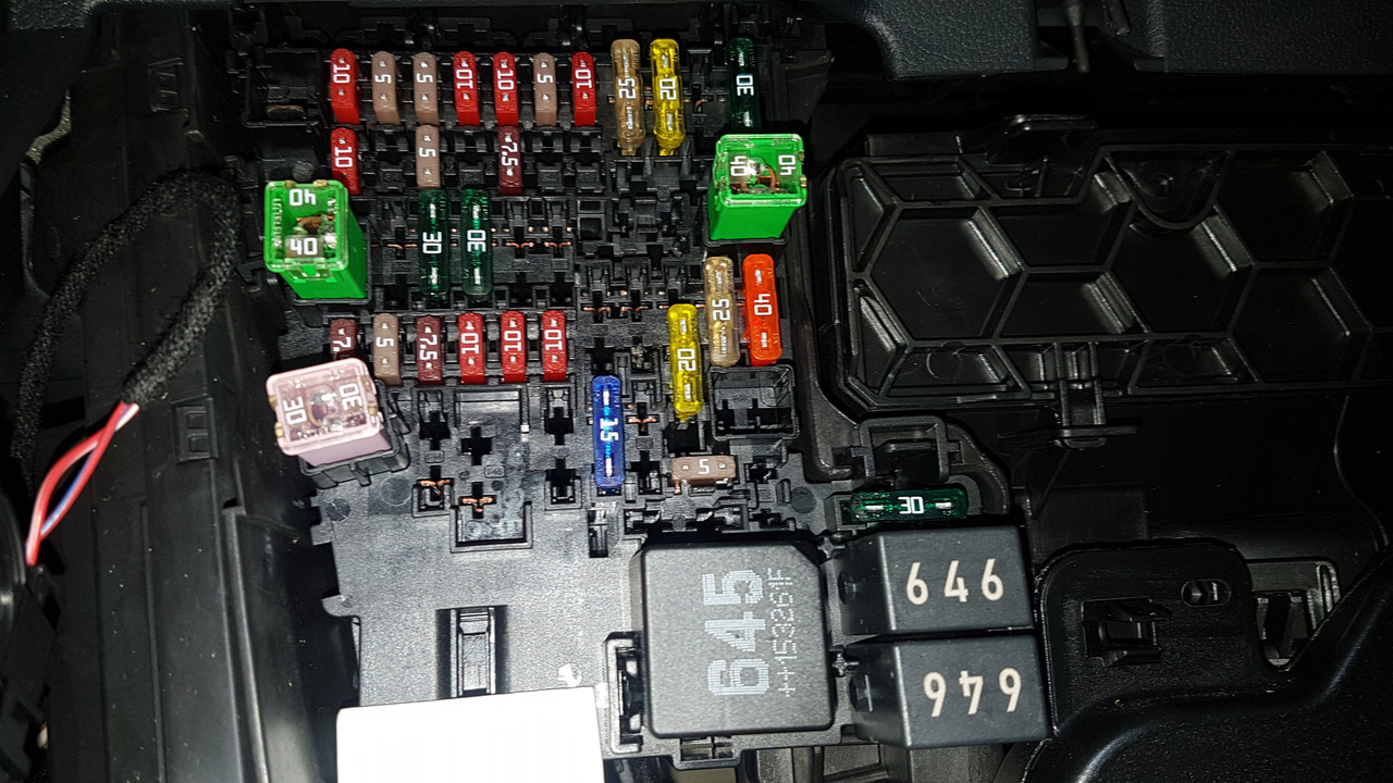

Basically I was fiddling with the clips to remove the cover of the cabin filter and my fingers managed to dislodge a 30A fuse and I have no idea exactly where it should live.
Handbook is at home so cannot get a reliable fuse guide.
When I start the car and start pressing buttons and testing what isn't working it appears my start/stop has a fault so can anyone help me with this please?
I have a pic of my fuse layout as below.

Update.  The electric window switches are also inop. As is the auto turn off stereo when you open the door with ignition off.

Perhaps this will help - https://fuse-box.info/volkswagen/volkswagen-golf-vii-mk7-2013-2020-fuses
Fuse no39 is for door modules/window regulators and is missing from the image above.

« Reply #3 on: 01 October 2021, 13:01 »
Thanks for the reply Watts, I was just about to post that I had found out it was no.39.
Panic over.
