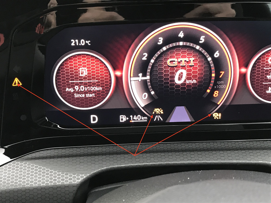

I have had my new GTi for 3 weeks now and I have had some strange things happen to the displays. I was driving last Tues at 5.30pm going out for tea when the display lighting dimmed 50% and then 10 minutes later, three orange warning lights appeared for no reason - see the attached photo.
We got to the restaurant and a couple of hours later when we left, the display lighting was fine and the warning lights had gone. The following day, the 3 warning lights came up again until we got home. The warning lights were not there in the morning.
The couple of days ago, the engine started by itself when I had parked the car with the engine off and the brake on while I was waiting for my wife who was getting some coffees.
I would be keen to know if anyone had these types of faults with their new MK8 GTi Golf before I discuss this with the dealer

The lights are related to travel assist/ACC, you have it activated as I can see the ‘runway’ image at the centre bottom of the screen, may be worth turning it off when you’re not using it, as for the car starting itself, that was probably the stop/start restarting the car as the battery voltage had dropped while you were waiting. If the headlights are set to OFF (not AUTO) The display can change brightness by itself as it has ambient light sensors built in, this is designed to alert the driver that the lights should be switched on.

In actual fact, unlike the Mk7, I don’t think you can set the headlights to off by default on the mk8 unless your below a certain road speed, although, I’ve coded mine to allow the lights to be set to sidelights or off at any speed, there are however definitely ambient light sensors on both the left and right of the dash screen that effect screen brightness dependent upon current ambient light level.
