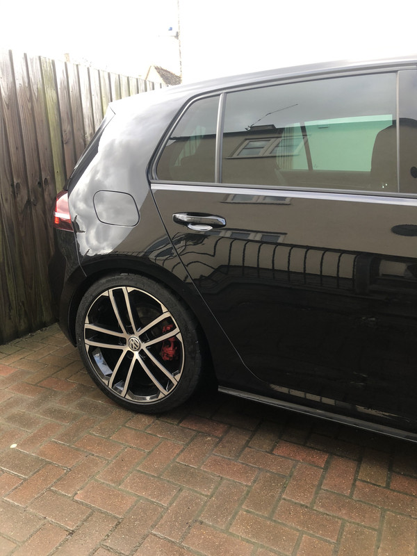

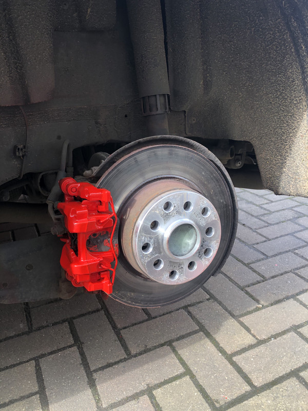

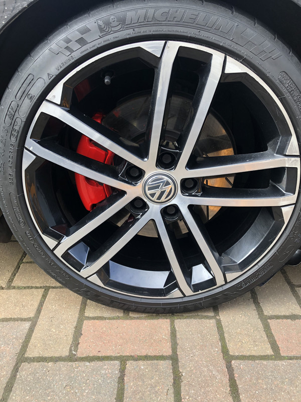

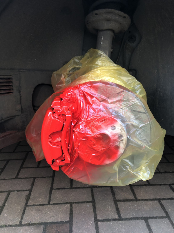

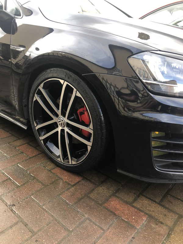

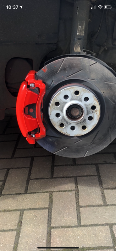

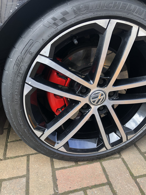

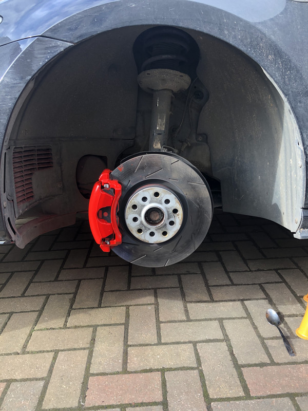

It was so easy!!!  :cool: I literally bought brake callipers paint from Halfords. I got a wire brush and brushed the crap out of them, I then sanded down with really gritty sand paper, then I sanded with a slightly finer sand paper until I thought it was where it needed to be, then got some white spirit and cleaned them down with kitchen roll and then simply applied the paint modestly and every 20-30 mins about 5 times.
Then finally I let it dry for about an hour and then applied one final layer as at this point the paint wasn’t sticking to very, very small areas, hardly noticeable - defo not noticeable when the wheels are on and that seemed to help.
