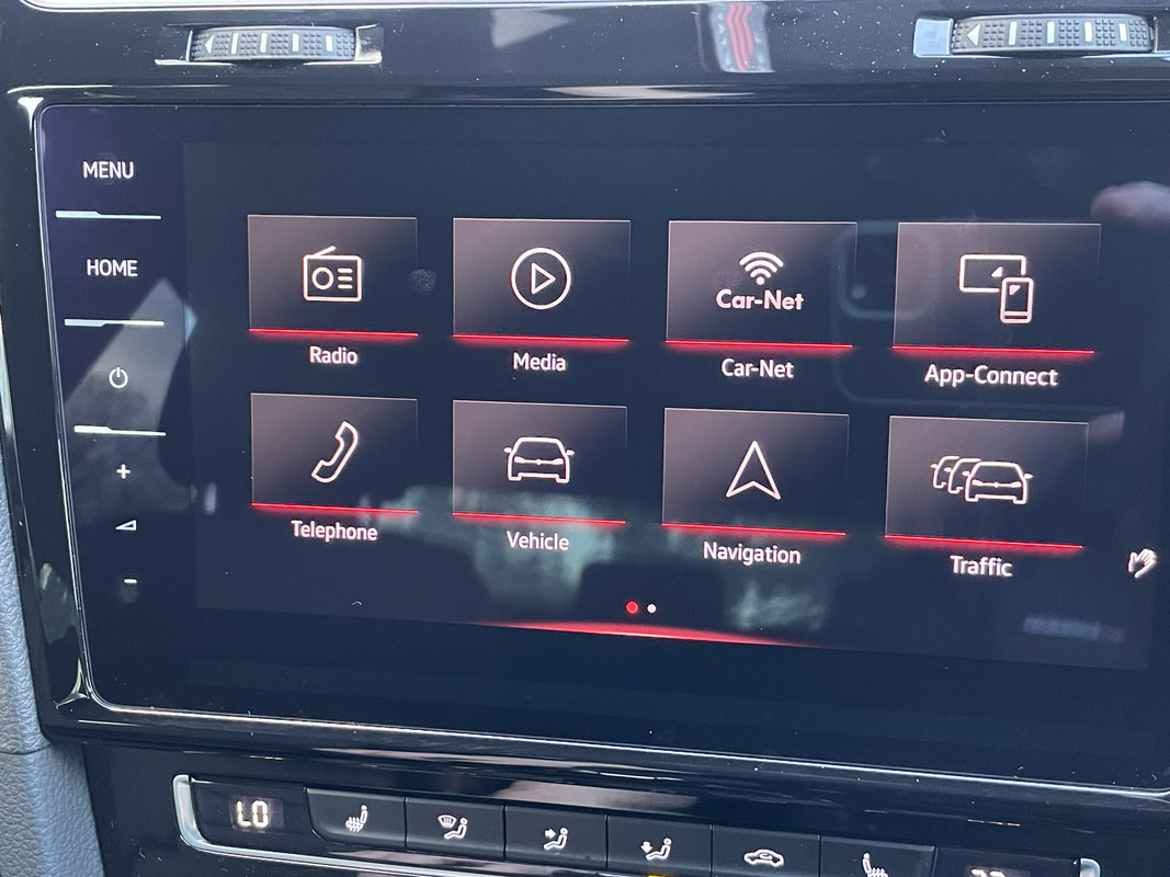

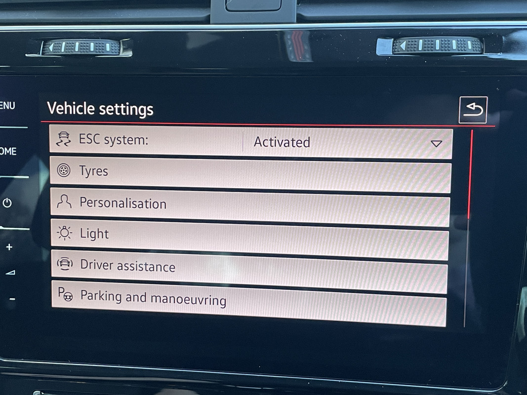

It's a mk7.5 so you can actually change these settings through the radio. I'll grab the pathway for you when I get a chance.
Offline willni
  • Posts: 1,478
Re: Light Settings
« Reply #5 on: 28 December 2023, 11:51 »
Menu > Vehicle > Settings > Light > Scroll Down to Light Settings.
Check the times on these, they could be set to zero.
